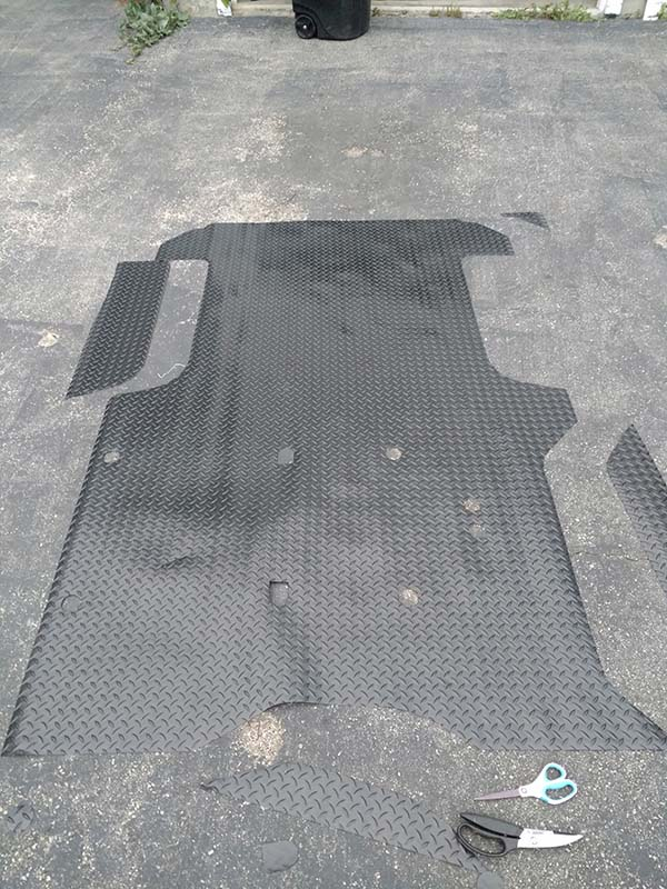

One of the first things I wanted to do was make sure the beautiful Chamonix carpet was protected.
Step 1) Purchase some rubber flooring. I got this 7.5 ft. x 14 ft. Diamond Black Universal Flooring from Home Depot for $100.
http://goo.gl/BEbnXI

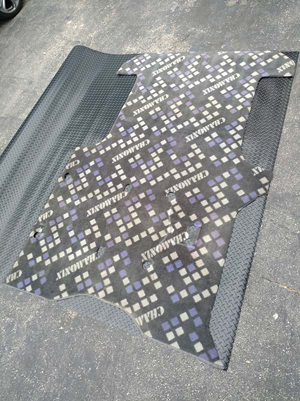

After doing some measuring, I thought that this was the only thing that was going to fit... I measured the original rug at 8' - so I thought I would have to trim the rubber flooring down the long way, but once I took it out and lined it up, it was the EXACT size of the rug on the SHORT (7.5') side. So either I measured wrong, or the flooring was 8'. Probably the former. I didn't actually get the tape measure out when I had it on the ground.
So I lined it up, drew out the pattern with a sharpie, and just cut away. I had some pretty standard (but newer) titanium scissors that worked well. Snips or shears might work better. I used a standard razor knife to cut out the circles.
All done:

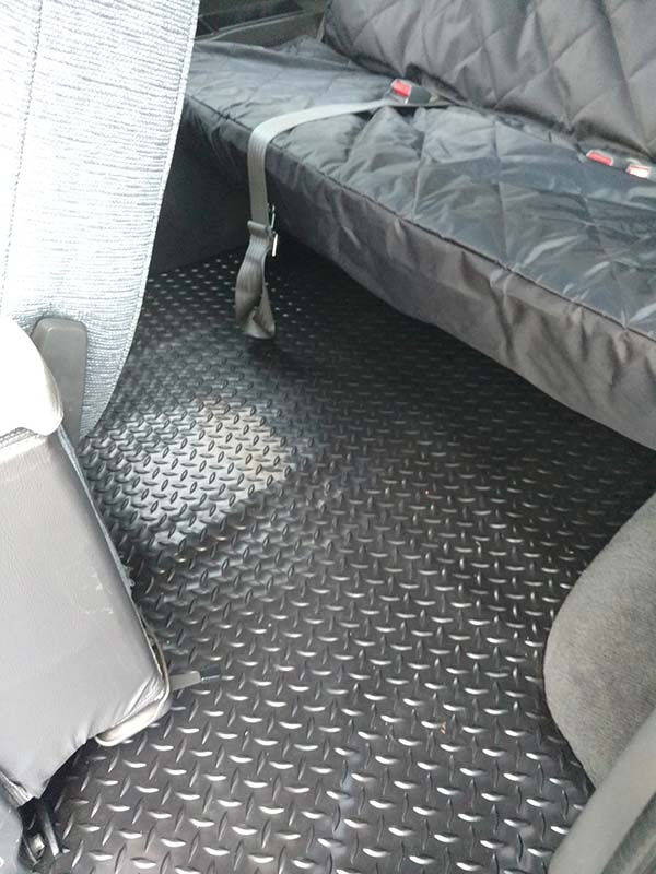

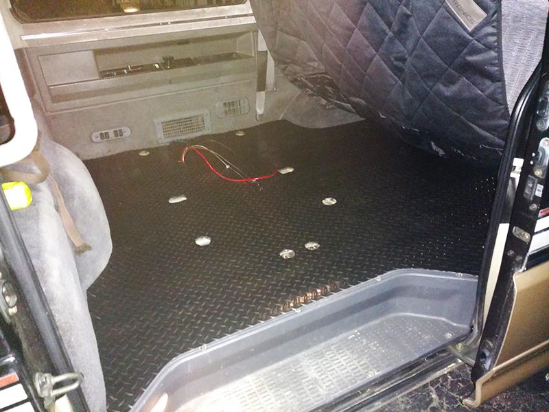

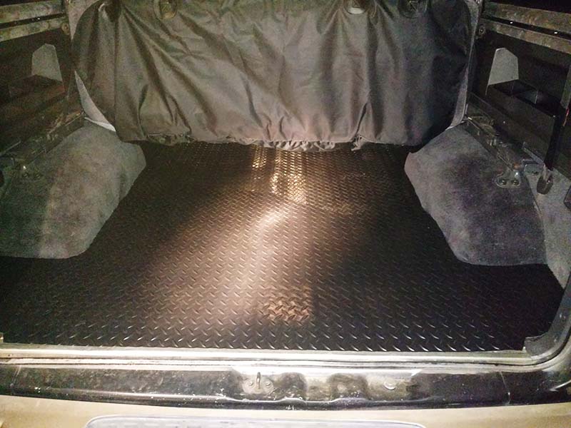

Installed:
I just reinstalled the carpet and laid this down on top. Fits great. Looks good.
I decided I wanted to keep it simple. I didn't screw it down under the rear/side trim. We'll see how time treats those edges.
Next, I'm going to cut some custom floor mats for the front out of the extra material. And I'll probably still have some left over to do the other two cars. :)

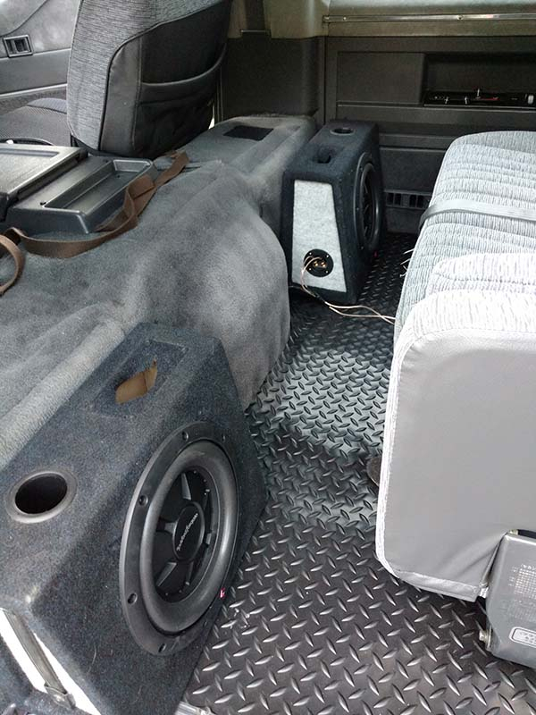

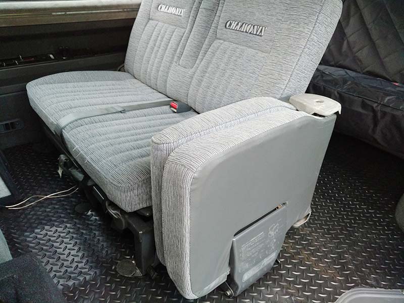

So, if anyone chooses to follow step, I'd recommend a few things.
1) Let the rubber sit out flat for a day or two before cutting. I've got a few wrinkles that I think could have been resolved through just letting it settle for a bit.
2) Cut a little bit extra room around the bench seat attachment points. It's hard to see from the pictures, but there are a few of the bolt points that are sitting on the rubber and sort of pinching it a bit. I'd just make a note of where the bolt points are sitting on the rug and cut a little extra rubber away. Alternatively, you could probably get crafty and cut LESS away, so the rubber covers the feet entirely. The OG bendable metal covering with a big of rug is quite clever, but as long as you don't mind lifting the rubber away when you need to detach the seat, you could measure a bit better than I did.
Otherwise, I think it'll be quite good in the long run.
