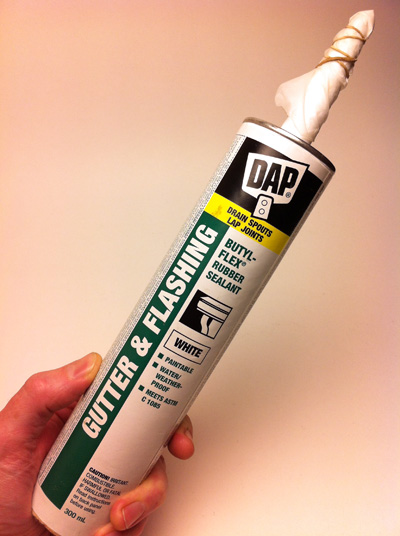

The sealer I chose is DAP Butyl-Flex Gutter and Flashing. Yes, it's used primarily for eaves troughs, but if you read the fine print on the back it's okay for Delicas too. Here's the important part: "Remains flexible and durable in temperature extremes (-40°C to 82°C) - won't crack or crumble. Forms a watertight seal against air and moisture." Okay, here we go.

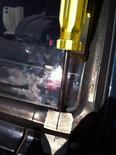

Now, my greatest fear in all this was chipping the edge of the windshild with my screwdriver. It really takes some muscle to force it through the hole in the rubber and get that precious "purchase" on the gnarly, rusted screw. Use some Liquid Wrench, if you have it. But really, be careful working at the edge of the windshield. I mean it.

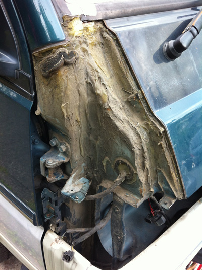

Okay, next you've got to scrape out what was sealing the seam before. If you're lucky, it's just the factory butyl tape, which is so dry and crusty you can practically scrub it out with a toothbrush. Okay, try a little harder, maybe a wire brush, an Olfa knife, some 80-grit sandpaper, and any scrapy thing that seems to clean the seam. Wire brush really did the trick for me.
If you're not so lucky, some previous owner has gone at it with a gallon of Shoe Goo or the like.

Not sure why there's another picture of the screwdriver at the end. I didn't ask it to do that. Maybe it's to stress the importance of not cracking your windshield jamming a screwdriver by the edge of it.

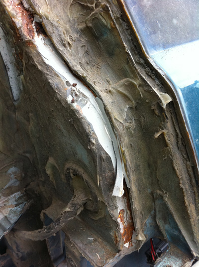

No wonder his fix didn't work. Water was pooling up behind the rubbery goo intended to keep the water out. Poor bastard. (probably institutionalized shortly after he sold me the van)
As I scraped out the Shoe Goo, I discovered a previous fix: looks like putty, the kind you put on storm windows for your house. For real?!! Clearly he didn't consult delica.ca, so I can make fun of him here. Oh well, putty scrapes out pretty easily.

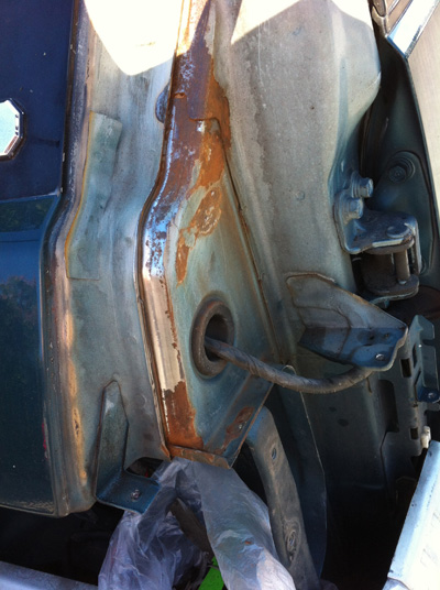

Here it is, all cleaned up. Properly, you should use some rust neutralizer, which I had on hand, but it needs to be washed off with water, and working on the street, I didn't have the means to dry the seam thoroughly afterwards. I had a hair dryer but lacked the 60 feet of extension cord to reach the curb, so forget it. I deemed it more important for the surface to be completely dry and free of loose material, than to be chemically free of rust. Its bound to come back anyway, no matter what you do, so just do your best. Oh well, maybe it will leak again in a few years and I'll go all red in the face. Or not.

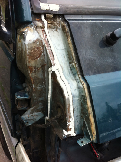

Next (once it's all clean and dry) apply a bead of DAP Butyl-Flex Gutter and Flashing Sealant to all the seams. Here's where you use that imagination Disney taught you and think like a water droplet. Anywhere gravity's going to make that droplet run down, there had better be sealant. That doesn't mean smear it all over the whole surface and hope for the best (like the Shoe Goo guy) just seal all the seams.
Notice how high up the bead of caulk goes. I made it reach up under the rubber gasket around the windshield, so it's like it's shingled. Water doesn't normally run up away from gravity, and I'm counting on that being the case. As long as the laws of physics hold strong, I've put a bead of caulk in the way of the water. And I didn't smooth it with the Caulk-Rite tool, because it's going to be hidden where nobody can see it. Really, it's okay.
