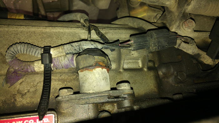

Hey! So I checked the wiring and there was power to the Sol with engine warm and ign on.
I suspect this means that the Sol is toast? My dash light works fine.
I'm going to check RMI and see what they have.

Re: Ain't Got No (satisfaction) Fourth Gear
That's the conclusion I'd draw as well. Replace the solenoid and keep your fingers crossed. Could you hear it clicking as it was turned off and on? I mean, it might be physically jammed so it'll click but not actually do anything, but if it was silent then that's definitely a problem.

Ya, it was silent as I had someone flicking the button. I also gave it a few 'love taps' from a wrench but nothing shook free. :) Sure hoping for 4th gear sometime in the near future.

Hey! Great news! I've got 4th Gear, wahoooo!!! It was the OD Solenoid. Such a small little thing affects such a major issue. Pulled one off a wrecked L300 and was quoted over $300 for a NOS part.
Only thing I notice now is that the gears shift pretty close to each other. This is probably normal but thought I would check. 2rd to 3rd has always been a bit 'slushy'. Feels like it's slipping but from what I've read this is sort of normal?
Anyway, great news if anyone else has this issue and is wondering about the trans. After checking for voltage at the SOL connector, try a used SOL.
Cheers.
