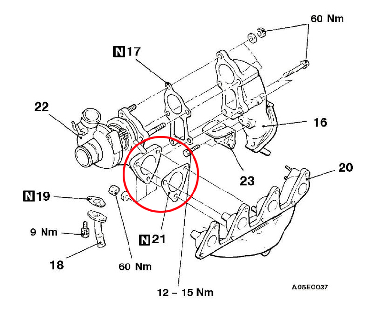

In the middle of this job right now. Turbo to exhaust unbolts fairly easily, but Turbo to exhaust manifold (3 nuts) is buried in there. Has anyone in Delica-land managed to unbolt the Turbo from the exhaust manifold without having to remove the entire exhaust assembly? If yes, then any tips would be much appreciated.
