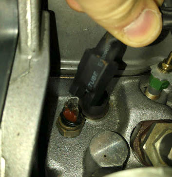

Your temperature gauge doesn't move at all? It's likely a bad connection to the temperature sender on the engine:
The connector gets really brittle, so take care when unplugging it. You're interested in the wire to terminal (A)- that's the one that drives your temperature gauge. Sometimes the connectors corrode and just need a bit of a clean, sometimes the wires snap off and you have to fit a new spade terminal.

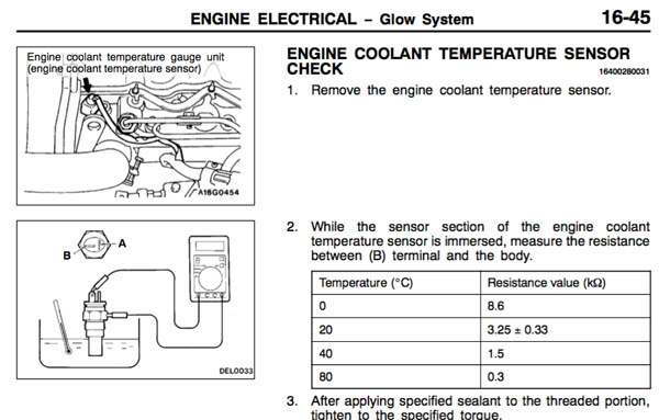

The temperature sensor is actually two sensors in one package- Terminal (A) drives the temperature gauge, terminal (B) goes to the glow plug controller. The workshop manual only shows how to test terminal (B) (typical, huh). If your temperature gauge moves a bit, but is always low, then it might be time for a new sender- part number MD050214, about $30.

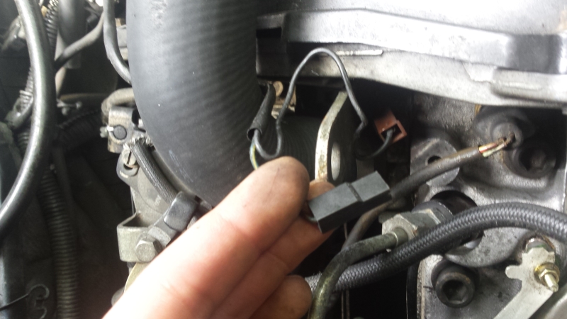

One other question. What is the plug that's right in front of the temp probe (is blocked in the picture by the doohickey that would be used when pulling the engine)? And why does it have two connector options for it? What's the difference plugging one in as opposed to the other? Ok a couple questions I guess..but I'm curious!
Re: Temp sensor/gauge not reading
There are multiple temperature probes on a 4D56. The one with two terminals (in the picture above) is screwed into the head, and drives the temperature gauge and the glow plug ECU.
The other temperature probe(s) are screwed into the radiator hose outlet (which is itself bolted to the head, near the lifting eye). Those probes usually only have one terminal each. One of them turns on the AC radiator fan when coolant temperatures exceed 95C to provide additional cooling to the engine. The other probe disables AC when coolant temperature exceeds 110C- again, to help engine cooling.

Interesting. It goes with the spirit of the Delica in the fact that there are so many options to choose and tinker with. Do you know which is which? And what is yours setup to?
In your photo, the black terminal you're holding (blue/yellow stripe wire) is the AC cutout. The brown terminal in the background turns on the radiator fan.
There should be another sensor on the radiator hose outlet- in your photo I think it's hidden by the #1 fuel injector. Connect your black plug to that, and see if your AC works. If your AC doesn't work, swap the positions of the black and brown plugs.
This one actually came up recently here: http://www.delica.ca/forum/viewtopic.php?f=6&t=17568
On my van I cheated- one of the sensors failed and I couldn't find a replacement at the time, so I just earthed the black terminal (blue/yellow stripe wire) to the firewall and left the brown connector dangling. That means that if my engine overheats the AC will not automatically shut off, nor will the radiator fan come on to aid cooling, but I'm pretty good at not overheating the engine so I'm not too concerned. One day I'll get around to fixing it properly. Maybe.

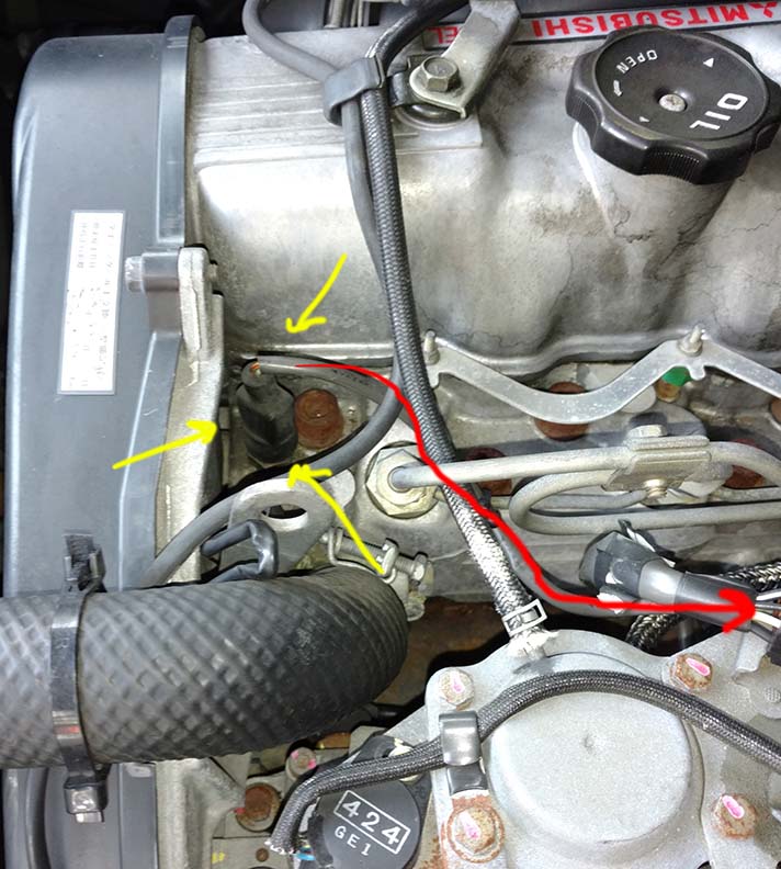

Post by pluckmyeyeout »
Growlerbearnz wrote:Your temperature gauge doesn't move at all? It's likely a bad connection to the temperature sender on the engine:
2016-05-21 10.25.48.jpg (121.68 KiB) Viewed 9880 times
OK, super newb dumb question. How do I remove it?
And to confirm, this is what I'm looking for? The yellow arrows? And I don't see a way to disconnect the wire anywhere on the red either...
TIA!
The black rectangular part is the plug- pull it straight up while wiggling it a bit. I don't think there's any kind of locking mechanism, but I repaired mine ages ago so I might be misremembering.

OK, I was able to pull the sensor and get some resistance readings off of it. I don't think they were spec to the model above, but I also just did a quick check. It changed when I warmed it up, so at least it's doing that.
So... Now... Assuming it's OK, how would I check the connector itself? Anyone got a part number for the connector? I was behind the instrument panel before and didn't find any loose wires, but is there a way to check with a multimeter either at 1) the wire coming out of the connector (at the engine) and 2) the gauge to see if it's going haywire somewhere in between.
