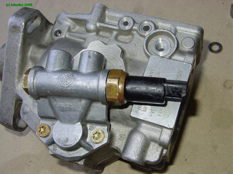

Cold start advance device: I've never seen one on an L300, though they do exist on some VE pumps. They're pretty primitive though:
