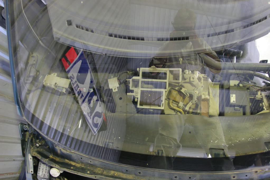

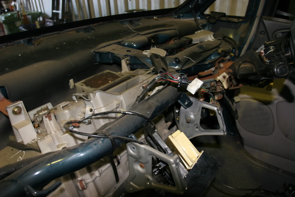

First you have to remove most of the bits that support the dashboard. Dashboard does not get removed....it just has to lift up enought to give the heater box some room to move during extraction.
The engine bay is a player here too. The intercooler had to be pulled so I could access the heatercore's 2 hoses at the firewall.
The box is easy to pull as long as the dashboard has been freed up to lift up out of the way.
The heater box and the circle identifies the offending leak. The clamp seems to rub against the core and causes this common leak. Thankfully its easy to fix if you know what you're doing.
the fresh plumbers grade solder clearly shows the area that was repaired. I also reinforced the area so that future leaks won't appear any time soon. I think a thin layer of rubber on that clamp plate would prevent leaks all together. If you are getting new core do yourself a favor and put a thin piece of rubber on that metal plate in the photo above.
