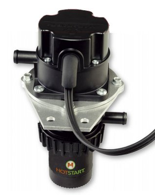

inline heaters are great but there are 2 main different types.
1) Convection type, very common, low cost compared to pump type units. Available at Canadian Tire/corner parts stores. Require the unit to be mounted low in the engine bay so that cold fluid will flow down and warmer fluid can flow up...usually inline to the heater core with the small port units(CT version) or installed at the lower rad hose with the bigger(Red) ported units.
inline 1.png (77.88 KiB) Viewed 7143 times
inline 2.png (63.38 KiB) Viewed 7143 times
inline 3 CT version.png (39.67 KiB) Viewed 7143 times
(no pump in that housing, just a big element).
2) Circulating pump type (superior heat up time, pumps fluid actively, can usualy have an internal thermostat so heater burnout can't occur).
The circulating pump type are far superior and more $$$ but they are not as limited position wise in the engine bay.
Here's just one manufacturer's websitehttp://www.enginepreheaters.com/product/ctm
