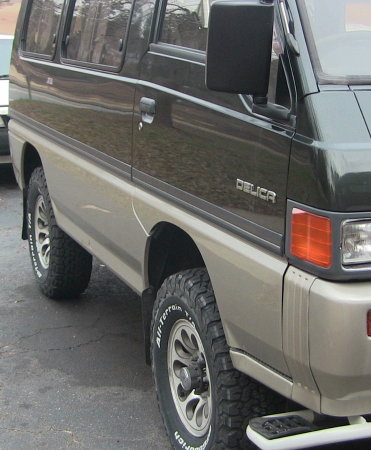

I put some forum stickers on the Deli, and I finally got a pic to work! I'm now rocking the MitsuMaple here in the "Deep South!" :M And were set to go in and get an alignment tomorrow morning!

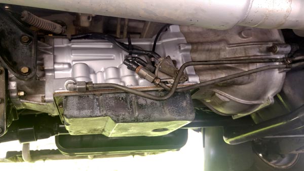

Picked up the van from the workshop where it received a shiny rebuilt transmission. Had the expected chat with the grizzled transmission rebuilder (who thinks everyone is an idiot) about adjusting the throttle/kickdown cable to achieve what I wanted rather than what he had set it to. He told me I was an idiot, and then explained exactly how to do what I wanted to do. And again told me I was stupid for wanting to do it.

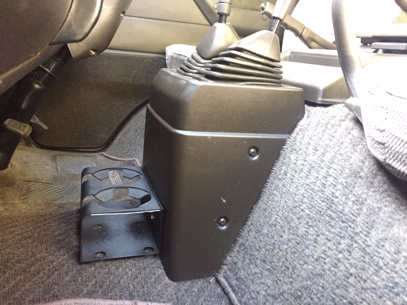

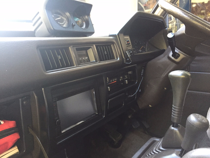

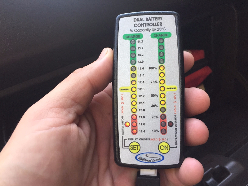

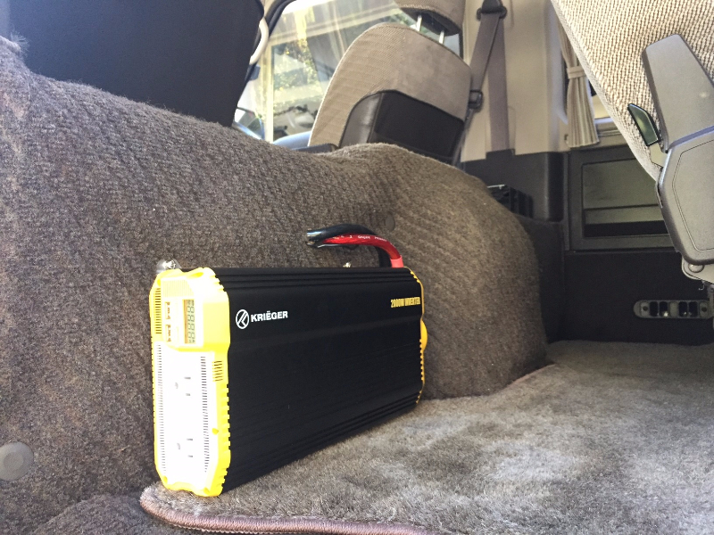

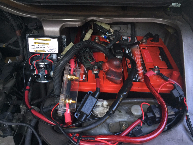

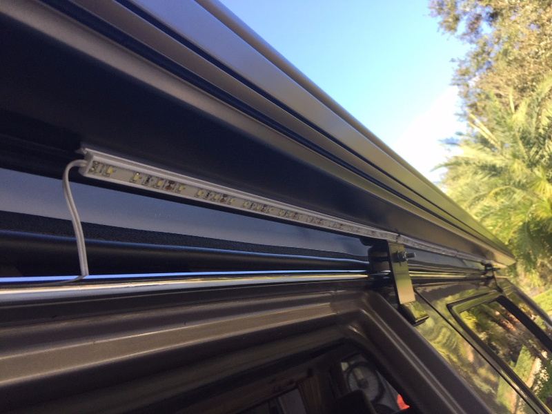

Last 2 months. Front lights, awning lights, interior LEDs, stereo, speakers, clean up front bar, powder coat all bars, dual batteries, controller, inverter, cup holders. It's now my dream van. Kids can't wait to go camping.

LDiz wrote:Last 2 months. Front lights, awning lights, interior LEDs, stereo, speakers, clean up front bar, powder coat all bars, dual batteries, controller, inverter, cup holders. It's now my dream van. Kids can't wait to go camping.
Damn, that's super clean and shiny. I wanna go camping too!

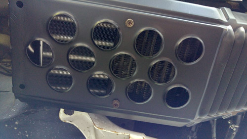

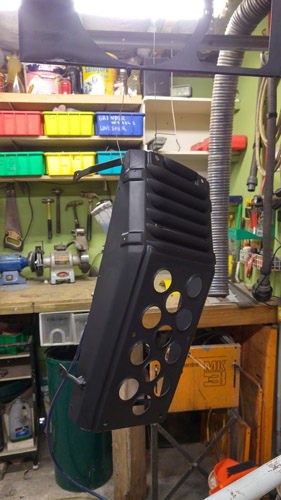

New and improved transmission cooler: the original cooler, a new, much larger one in series with it, a 7" fan on top (not pictured), all in a nice discreet box (made from the old cooler grille to keep it looking original. Ish.)

Not sure if it works yet, as my transmission temperature gauge hasn't arrived yet, but the in pipe is much hotter than the out pipe, even without the fan on.
How are you finding the front lights and awning lights? I am looking to do those upgrades soon.

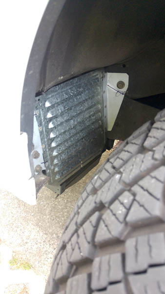

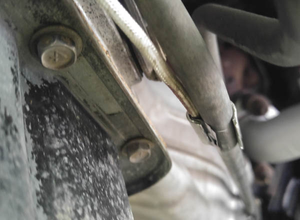

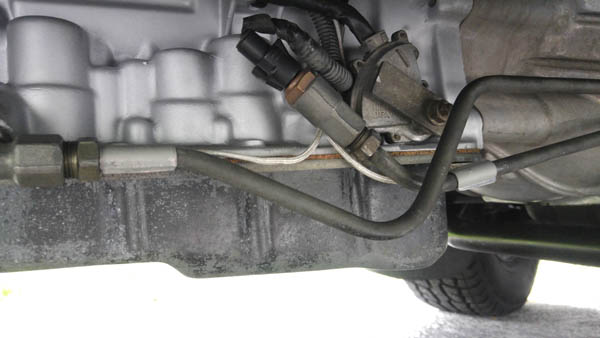

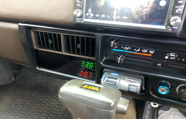

Fitted (cheap, but surprisingly accurate) temperature gauges to the transmission's fluid outlet and inlet. Red for outlet to cooler, green for inlet from cooler. Sensors clipped to the pipes because easy and accurate enough.
Oh and look, there's enough room for 6 more gauges. How handy.

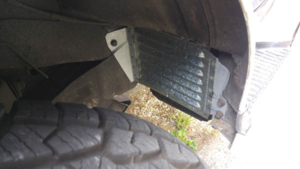

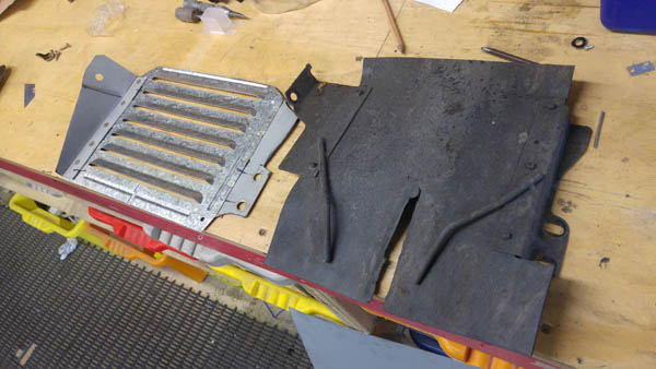

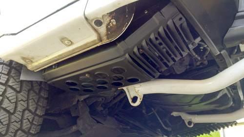

Made some new louvred panels to replace the rubber flaps in the wheel wells, the idea being that they'll let more air through from the aircon condenser and transmission cooler. If it works I'll paint them black, but until then they're redneck galvanised steel.
thelazygreenfox
Posts: 904
Location: Coquitlam B.C.
Location: coquitlam canada
Post by thelazygreenfox »
GB
Awesome idea to monitor the trans temperatures in and out. Very ingenious. Interesting to see temps under load and in the heat climbing also how long it takes to cool down.
