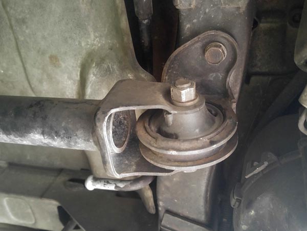

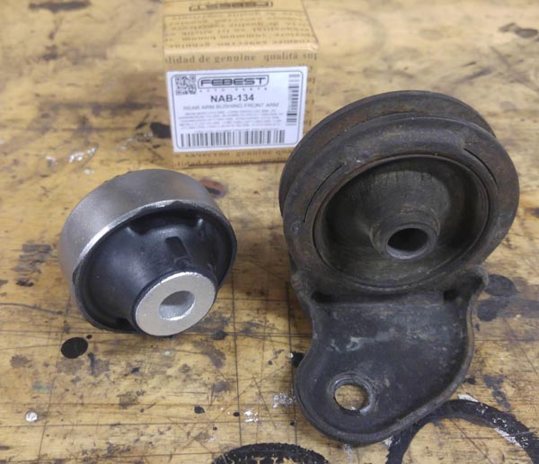

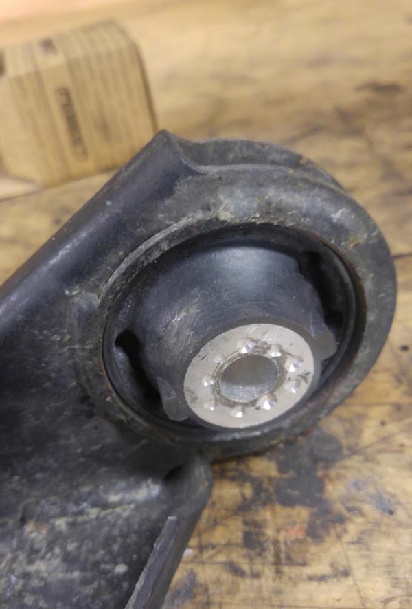

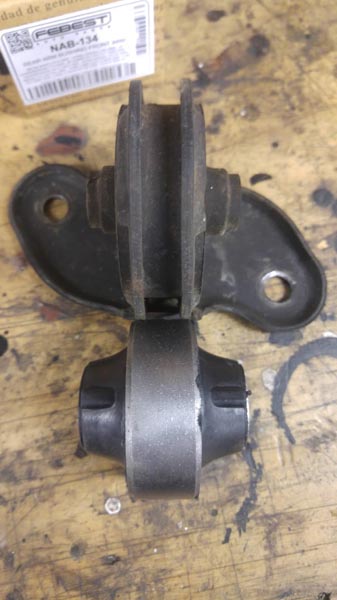

After trawling far too many Google-translated Russian message boards, I've found a bush that fits in the upper transmission mount brackets (usually only available from Mitsubishi if you buy the entire upper mount assembly. For about $400. Ouch.)
Nissan Micra/March/Tiida/Cube/Versa/ front suspension lower arm rear bushes. $16 each. Febest part number NAB-134.

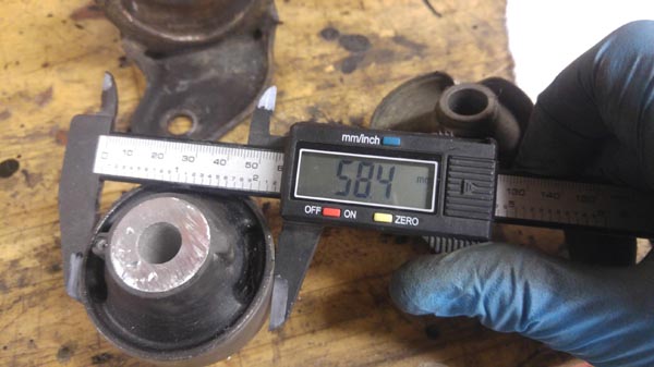

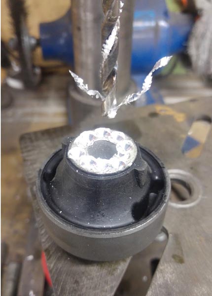

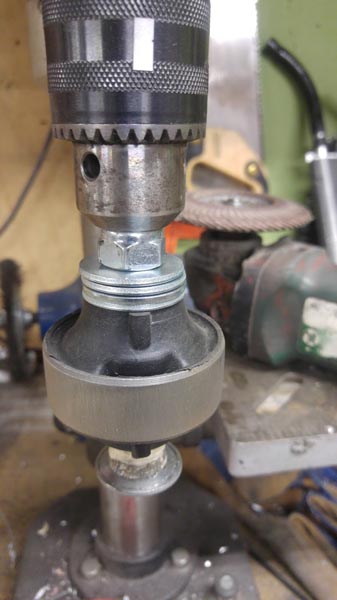

The tube in the middle is about 6mm too long. To prevent burning the rubber I drilled 3mm out of each end, then finished with a file. It's alloy, so easy to work.

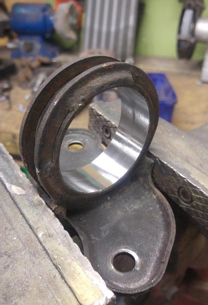

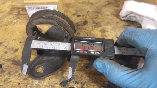

The bush's outer diameter is about 1mm larger than the mount, but it's a press fit so merely cleaning up the mating surfaces was enough. Flap wheel in a drill for the bracket, angle grinder flap wheel and the redneck lathe for the bush. Again, being careful not to get the bush too hot.
Install bush with a press (aka sledgehammer and a chunk of exhaust pipe as a mandrel) and it's as good as new.
Before and after shots:
The bushes are stiffer than the old (failing, worn-out) bushes, but I haven't noticed any extra vibration or noise. I'm declaring it a success.

jejoenje wrote:Out of interest, we're you getting any symptoms causing you to investigate the bushes?
Mainly they just looked worn and saggy, with some cracks in the rubber. But since replacing them (along with the engine mounts and main transmission mounts), I've noticed there's no more slight shudder on takeoff.
