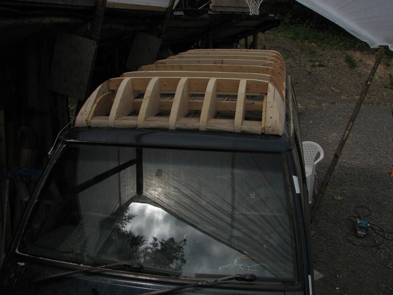

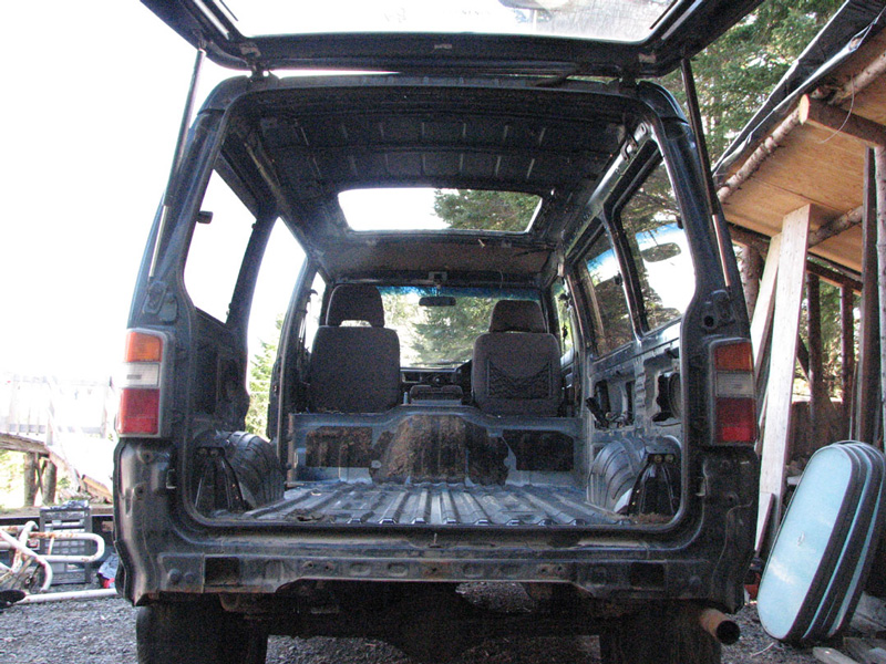

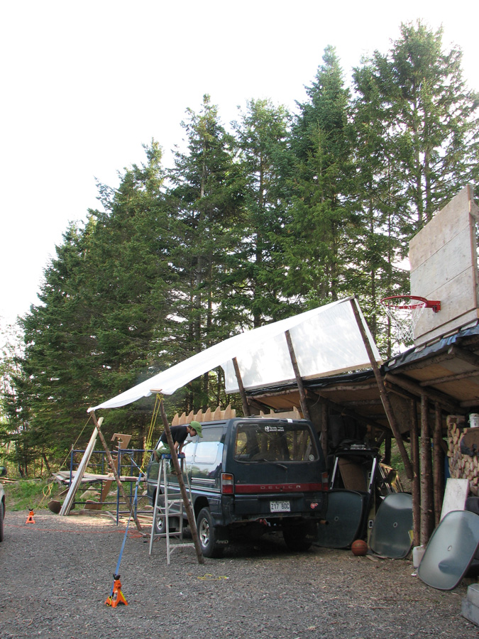

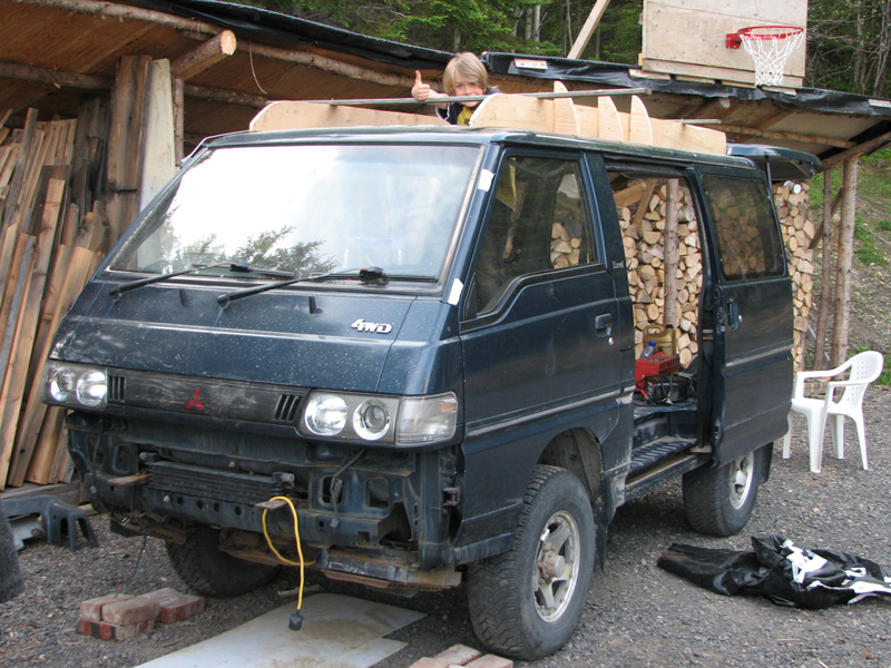

Here are some pictures of an ongoing modification of our L-300. We planned on transforming it into a camperized vehicule by the end of 2011. Look at the picture's names for more details.
We want to sleep 6 inside when necessary (4 children in the pop top area, 2 adults in the main area). We've been looking carefully at other's projects and are grateful at this Delica community for sharing their ideas. Hope our project helps other to do the move...

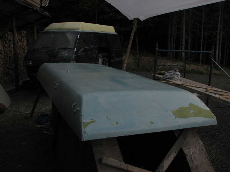

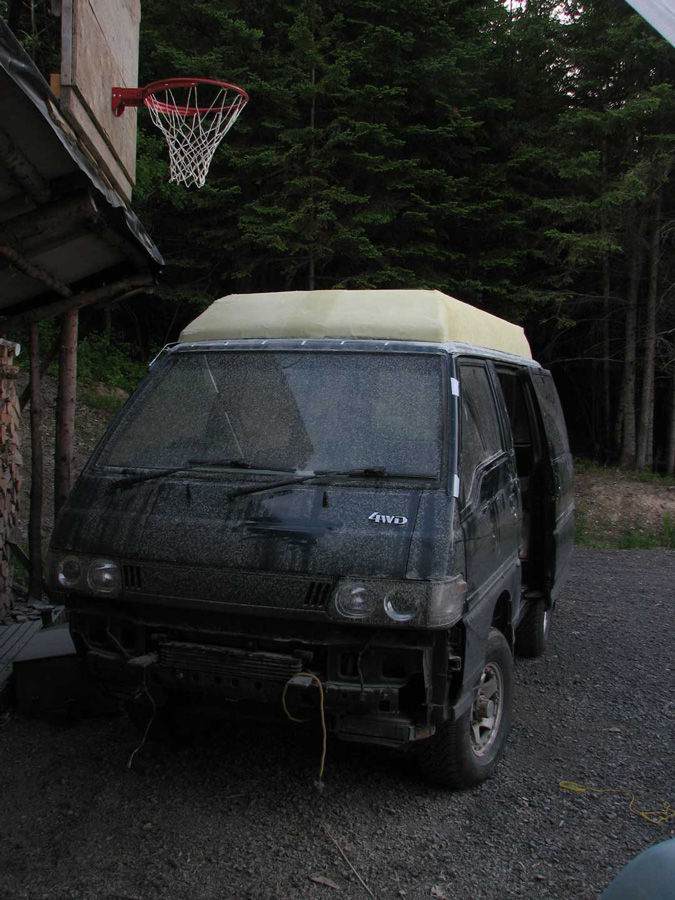

For now on, I prepared the first and secondary mould. The final roof should be moulded this week, with fiberglass cloth, mat and epoxy. Exterior finition will be white gel coat (polyester resin) applied first before the fiberglass.
The interior was ripped off a few weeks ago. Cutting of the roof should be done around Canada's day. I was lucky to find 2 old Westfalia hinges and a push bar to raise the top. If everything goes has planned, I should have some pic of the fitted roof by july 4th.

Whoa, that's quite the set up. The wood framing: Is that temporary for moulding or will that remain there? Also, how much of the existing ceiling will be removed and how will you be making the children's bed, as it were?

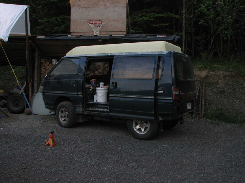

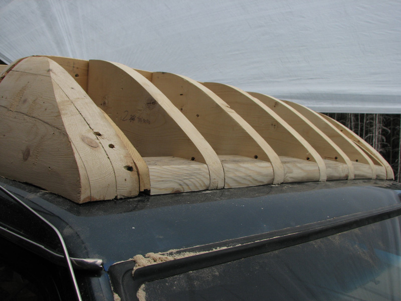

Some more pics.
Davy
Re: Pop-top, definitively!
Posted: Fri Jun 24, 2011 8:25 am
by lost2
Again...
Posted: Fri Jun 24, 2011 8:28 am
by lost2
And again...
That's it for now.
Davy

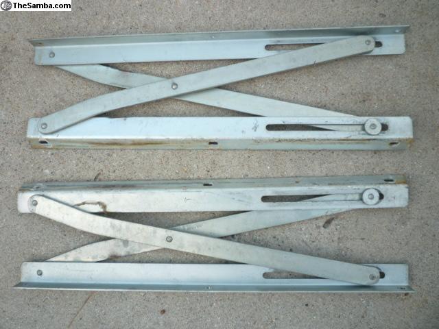

Another point: Could you photograph those Westfalia hinges for reference? I realise in my first post that you already answered my first question, but still what kind of shelf for the kid's bunks? How much of the original roof will be used? Great looking mould, Lost2.

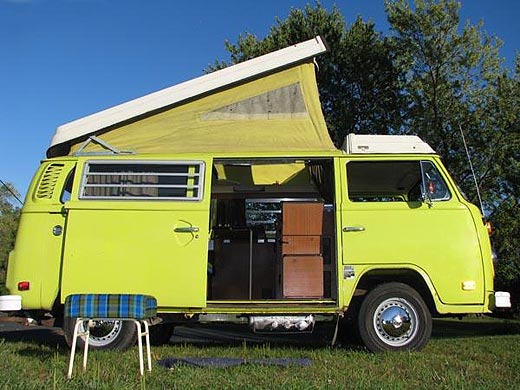

Top will be hinged on the short side. To give a better idea, here are some pics of a Westfalia vehicule and hinges (actually these hinges are from an older version than the ones I have in hand). The entire top will open wide in the back, as opposed to this picture, where the "3/4 pop-top" opens wide in the front.

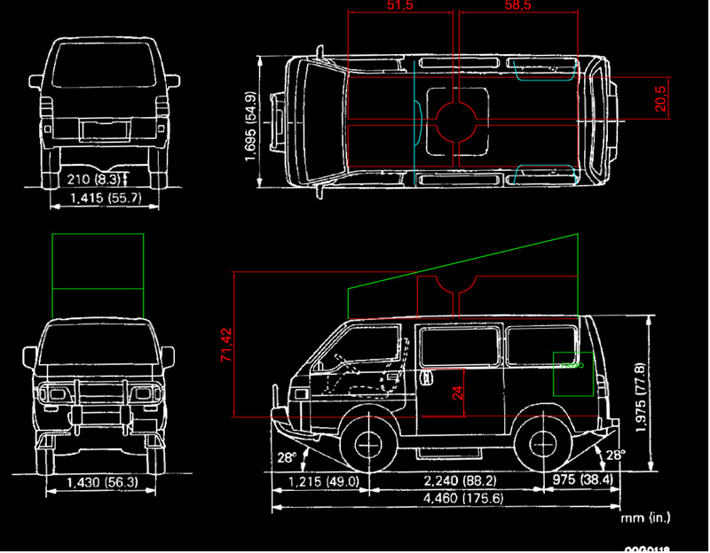

Here is a quick sketch we made to see how to fit the kids on top. The access will be from the center hole.

Very nice work! That's one heavy duty mold, I would have used construction foam, but yours would stand up to many Delica pop tops being formed. Many a Delica owner would drive to the Gaspe Peninsula for one.
