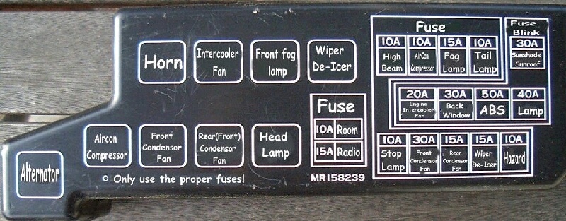

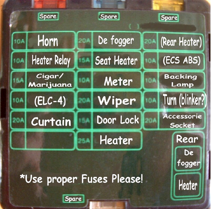

I don't even have a map of the fuses to know what they power. Does anyone have any info or resources for learning about the electrical and how to work on it. I am currently traveling in the United States and I haven't found anyone who can test it for me or help me fix it.

Here's the english version of the under dash fuse box you requested Here's the under hood unit. As for the wiring schematics.....those are harder to come by.

Thank you for the translations.
