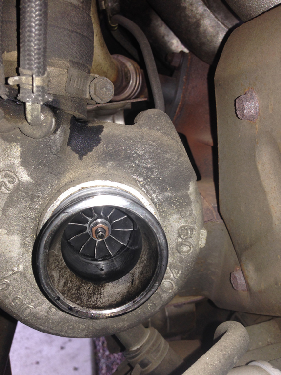

I finally got to taking a look at the turbo. I removed the hose that attaches to it and tried to spin it with my finger. The blades of the turbo fan (?) do look a little worn, but it spins freely and smoothly. I took a picture in case there is something I am missing here. I wonder what else would keep it from engaging. Should I check fuel and air filters?

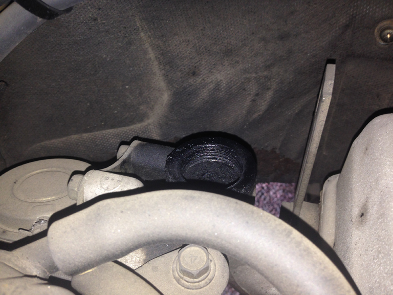

I did notice something odd. Looks like some component behind the engine that is suppose to have a cap, but does not have one. Anyone know what this is?

Re: Lack of Power / Possible blown turbo
Umm... If that is where I think it is ~ that is where the waste gate is, in which case you appear to be missing part of your waste gate (the relief valve).

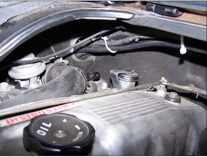

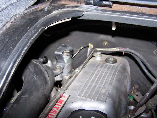

I've added 2 pictures which I think are of the same area as your 1st. picture. This pop valve is to protect the engine and will open @ about 15 psi to control maximum turbo boost. It looks like yours has disappeared. I have added a bracket to stop mine from opening as it opened about 11 psi. If the space is open you will effectively have no turbo boost. You can blank it off or purchase a used one from an old motor. When you run the motor does exhaust come out of the opening?

So my current theory is this.
The inlet relief manifold for the turbo somehow got loose. While I was ascending a steep grade under load it popped off. I did notice when I experienced the sudden lack of power that there was an accompanying and noticeable louder sound from the motor. Since the motor had been stressed going up the hill it was hot and once I stopped there was no coolant circulating and air flowing to cool it down and the temperature level rose to the point where some coolant boiled out through the overflow. Hopefully with the installation of the inlet manifold relief valve, I will once again have turbo power. I plan on installing a pyro since all the trips I take with the van involve uphill climbs.
Thanks for the help. If you think I have missed something here, please pipe up.
@lrp374 - yes. When I run the van, exhaust does come out of that hole.

anytime I hear that the overflow bottle has dumped coolant, I think pressurized cooling system via cracked head. Watch your coolant levels like a hawk - both in the overflow, and in the radiator. You may see no other symptoms of a cracked head except this. I know your inlet relief valve is gone - but why did your engine dump the coolant? If you do continue loosing coolant - drive with the radiator cap off and and take it easy.
