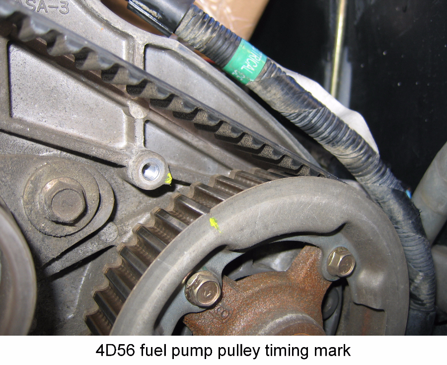

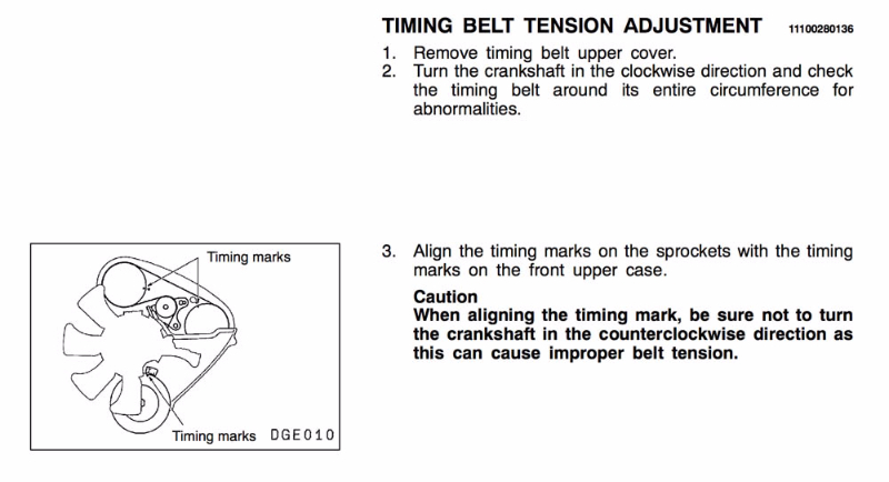

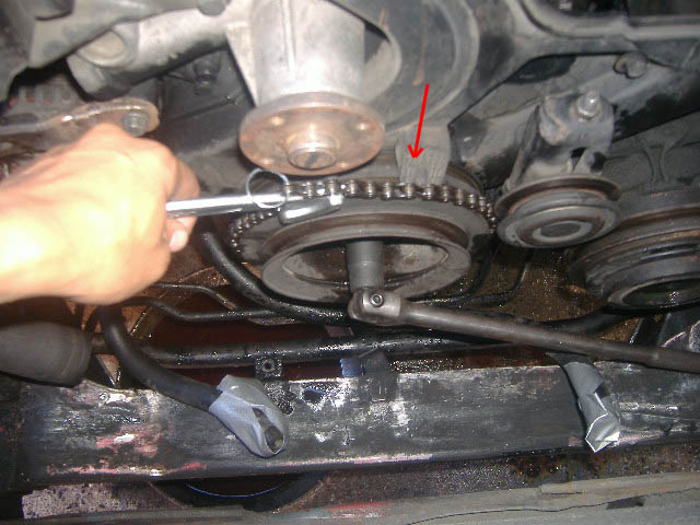

Before removing the turbo (a pig of a job), I'd remove the top timing cover and have a look around inside with a flashlight for any spare bits of balance belt. If you don't see any, turn the engine until the cam and fuel injection pump pulleys point to their respective timing marks, then look for the timing marks on the lower plastic belt cover- the crank pulley notch should be pointing at the leftmost "T" mark on the belt cover (red arrow in the picture). If any of the timing marks are misaligned you've slipped a tooth. Here's what the workshop manual* says:
(Camshaft sprocket: the timing mark on the sprocket is a little round dent over one of the teeth)
(Crankshaft pulley: Notch on the crank pulley should align with the leftmost "T" mark)

(Injection pump: Notch on the sheet metal belt deflector over one of the teeth)
