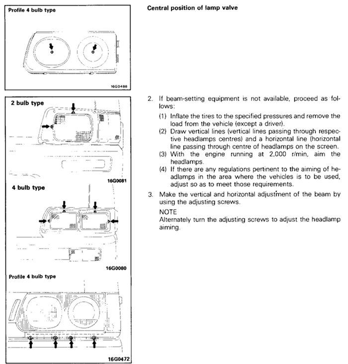

I've got an L300 1991 Chamonix in Vancouver I've seen some loose references on Delica.ca and some Aussie/UK forums that there may be a way to adjust the tilt of the headlights? I swear mine have dropped down over the 4 years i've owned my Van.

Sounds like you need to download the workshop manual http://www.delica.ca/forum/viewtopic.php?f=17&t=17809 ;-)
Here's the relevant entry though:

Thanks Growlerbeanz. Still not clear which screws are "adjusting screws" from the manual (typical - are these the headlight body screws or are their screws on the inside of the body??) but I'll figure it out I basically just need to confirm there is a way to do it.

It's the screws with the big arrows in the diagrams. They're 10mm hexagonal head screws with a phillips slot in the end. They're tricky to see if you have the brush bar on, but the plastic surround is cut out around them. one screw adjusts up and down, the other side to side.
