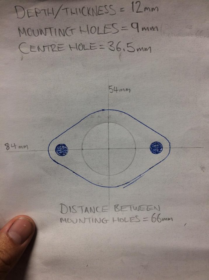

I've ordered some 90 degree 1.75"-2" silicone reducer hoses and intend on making up a straight-out but very short intake stub, it looks tight but going off rough measurements, the flexibility of the hoses should allow for enough wiggle room. Though it may mean trimming them down and I'm certain they would touch but we'll see how it goes!
So I have a 2D design for the flange plate required but my friend in the sheet metal factory has gone AWOL this week.
This design is to the spec of the original intake stub and my idea is to get a 1.75" pipe welded to it maybe only 1"-1.5" long, depending on the thickness of the pipe I go for there will likely be some overhang form the plate's centre hole, but I'll just fill it smooth with some epoxy putty/resin so it doesn't mess with the air flow.
Intake Flange.jpg (331.4 KiB) Viewed 16504 times
Intercooler, because why not.
Genius! Wish I'd thought of the straight inlet stub. On mine I had to replace the lower mounting bolt with a stud and nut, because the pipe is too close to the hole and you can't get a bolt in there.
