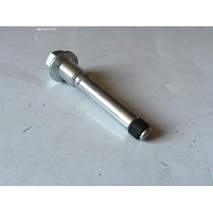

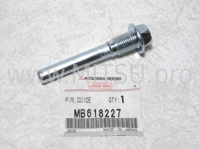

MB618227 top pin (plain pin). CAD$11 from Amayama.com
MB618228 lower pin (with rubber tip) CAD$10
The lower pin is supplied without the rubber. To get the rubber you need rebuild kit MB857840 (superseded by 4605B977 CAD$30)
