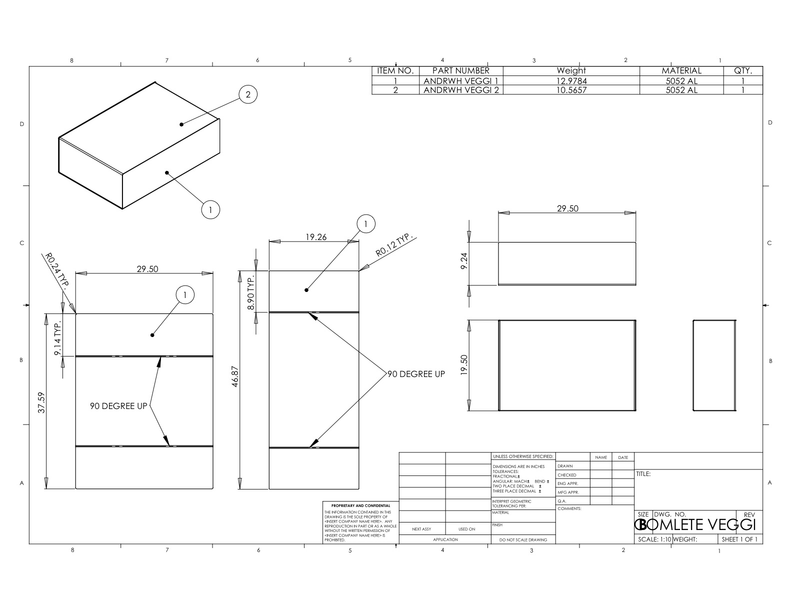

tank... (sorry about the quality, had to convert it to Jpeg)
minor rework of the exhaust may be necessary.
I should have one or two tig'ed up this weekend and will need a vehicle to design brackets next weekend.
anyone serious about this kit and want a free install??? I will need your vehicle for a few days at least so I can take my time and take a load of pictures for the color instructions I am going to supply with each kit.

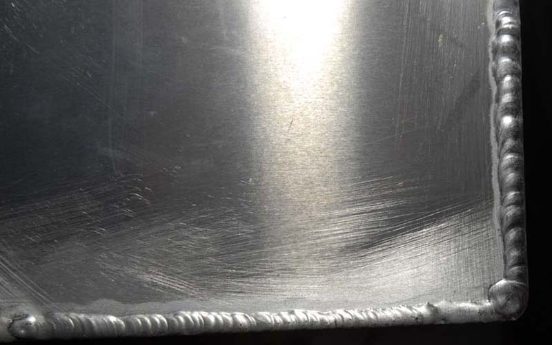

anyone guess what this is????????
one down, 7 more to go.
