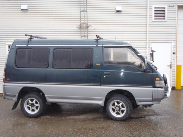

I think that we may have a winner with the lightning fast wear with underinflation idea.
I routinely take my pressure down to 15 psi or sometimes less when I'm stuck....I should take pictures.....Then I drive 10km of pavement to fill them back up. It sounds like this action makes this wear plausible if not likely.
Bosc's Deli
Bosc's Deli
I'm terrified of spending $1000 on new tires to have it happen again.
I don't like these tires anyway, just had a good deal on them (everything for exactly $500 tax inc.)
Almost all of my use for my deli is on the beach, so on sand, which requires more floatation than these wee 27x9.5 r15 tires can give.
North Beach Haida Gwaii
I would love to buy 4 new tires that fit with a width of more like 11.5. I may need a lift and likely new rims too.
Does anyone know how big (31 i think) and especially wide you can go on a stock deli?
Any tire suggestions are very helpful as i have to order them in since there is no tire shop here.

I wouldn't go any wider than 10.5" unless you want to change your backspacing....which would be pretty tough on the bearing. 31x 10.5 fit nicely with fender trimming for clearance, especially under articulation.

parkside wrote:I wouldn't go any wider than 10.5" unless you want to change your backspacing....which would be pretty tough on the bearing. 31x 10.5 fit nicely with fender trimming for clearance, especially under articulation.
Sounds like the best tire size for me.
I was under the impression that to go this big would require a lift as well as the fender trim.
Anyone running 31'x10.5 r15's out there?

bosc wrote:I was under the impression that to go this big would require a lift as well as the fender trim.
The "official" word is that 31s require some trimming and bashing, but no lift, 30s require nothing, and larger than 31 requires a lift.
That said, it seems that all tires of the same size are not equal, nor are all Delicas, so your personal situation may differ.
