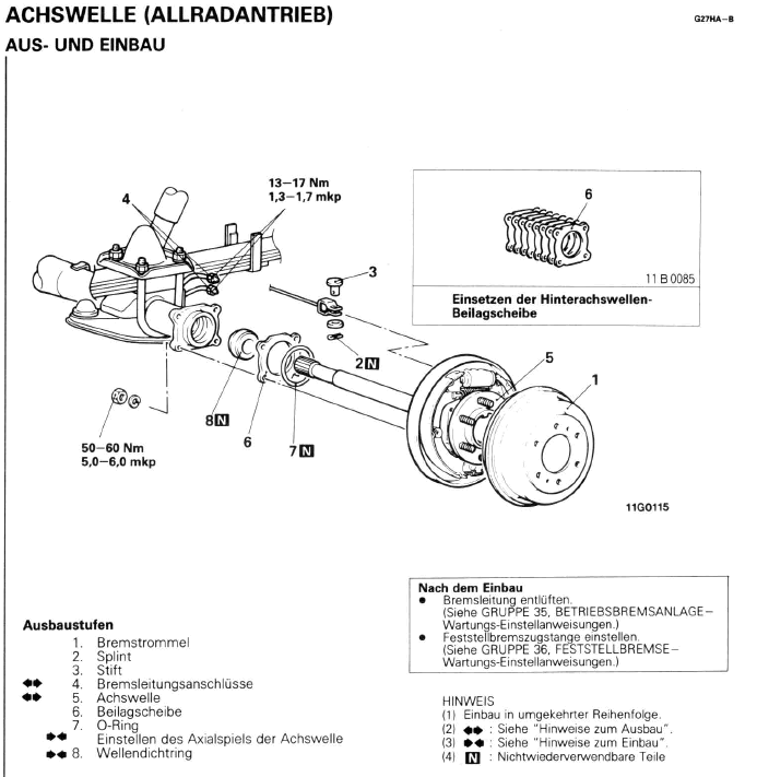

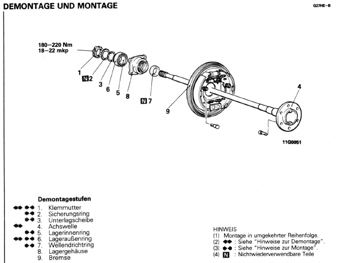

Hello All.. I seem to have developed a noisy rear wheel bearing :-( Has anybody had the joy of changing one of these, or can someone please point me in the direction of - Exploded rear bearing diagrams or any other direction + advice..

Hope that helps at least a bit. Also have a "how-to" change the bearing, but all in German...

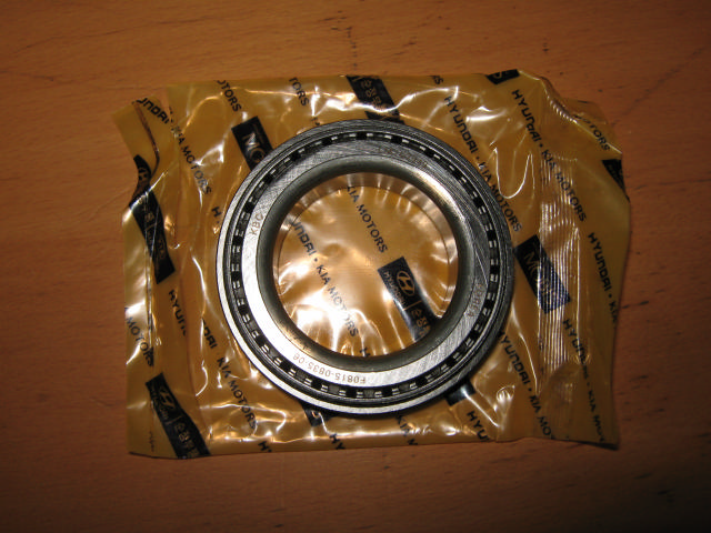

We have it in stock.
$65 each, fits delica/pajero/spacegear.
