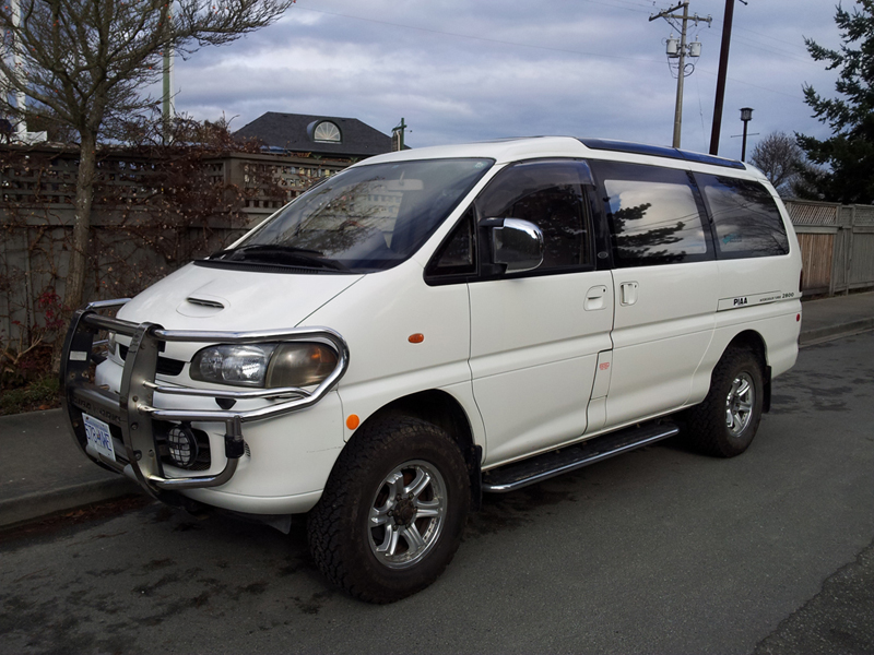

Just got myself a L400 from David here in town. I got the Delica to use for hiking and plan to eventually camperize the back. Here's a picture of me on the south summit of Mt. Arrowsmith near Port Alberni: http://i.imgur.com/UdaBj.jpg
I've already had to tighten the alternator belt (which was so easy!) to git rid of some squealing. Is there any other things that I should check/replace/maintain? I also need to drain the windshield washer fluid (just water currently), what would the easiest way of doing this be? Also, is there a separate container for the headlight nozzles? They don't seem to be working...

Nice bump bar on front!

I wouldn't say it's no big deal; often's the time in dirty/dusty places where I'm having to get out and wipe off the lenses so I can see at night. Safety first, SpongeBob!There's no separate container for the headlight washer nozzles, and pretty much common issue for not working properly ( no big deal ).
