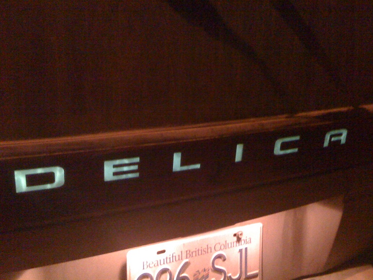

Hey, sorry, I couldn't find this info on the forums! - went to Canadian tire to find the bulb to replace the rear illumination that says DELICA (L300). I used profister's writeup in the l300 reference section, to find bulb 891 (i think) and it doesn't look like they have it at Can Tire (guy said they don't carry them anymore?). I'm going to look at Lordco on Monday. Any ideas what bulb I can pop in there, and where to get it? Cheers!

OEM#: MU820004.

Thanks Falco, can I find this bulb at Lordco? Also, from the few posts I've found regarding this fix, it looks like there's actually 2 bulbs in there. Can anyone verify that? Cheers!
Re: Anyone know the bulb part# for the rear DELICA illuminat
That is the Japanese OEM number, Lordco might have it as there is someone in Lordco cross referencing the Mitsu numbers, either way it's a start and a cross reference should be available, you could also take the old bulb with you when you go to Lordco, or CT, or Napa, &c.,......

NAPA carries them. At least the one in Langley. I bought four of them there 2 weeks ago for a different application.

Found GE 891 bulbs at Lordco. Looks like the same bulb from the original post in the L300 technical section!
Here's the product:
http://www.qualitydist.net/gel-891-bp.html
Same specs as the one you posted above jesse, so I'm sure it'll work. Grabbed two, and I'll replace them this week.

Problem Fixed, the GE 891 bulb from Lordco worked great!
