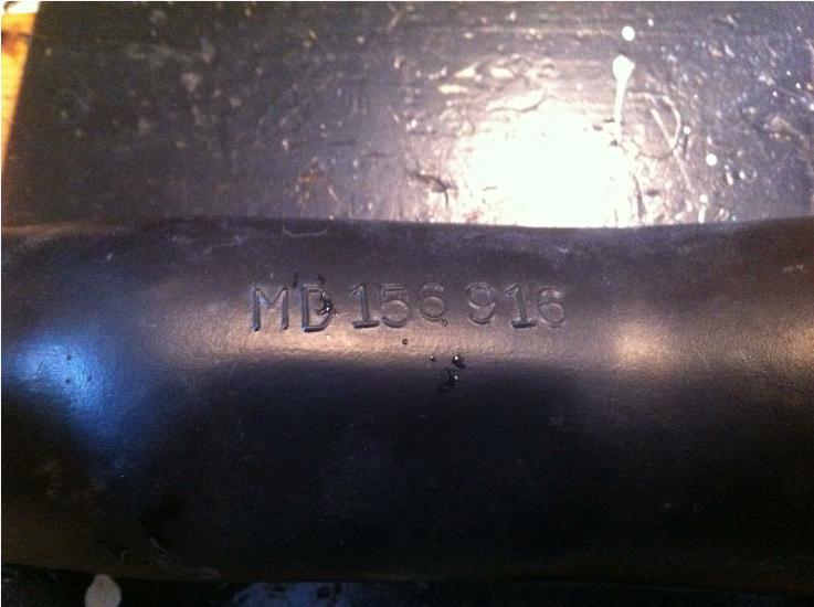

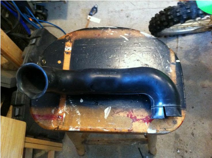

I was cleaning out the garage today and I found this part that I remembered came with the van. It looks like it's part of the air intake system but I can't figure out where. I've looked at all the diagrams that I can find and havent found anything that fits.
Anyone?

It fits underneath the drivers seats. Slide the seat forwards, remove the panel behind and it just slides into place under there.

Thats what I thought.. And I tried to stuff it in there before posting but it just didn't seem to fit.
I'll giver another try though.

I just tried again and it won't go. The length looks right but there's no way it will fit with air filter there.
Am I missing a few other pieces?

I don't think you're missing anything. From what I remember it's a tight squeeze. Only one end connects to anything and there is a screw that holds it in place against the side of the vehicle.

You know there is an intentional gap in the system? I'm not sure which bit that it by looking at it, but it seems like one side of the gap, ah I found a pic:
(url'ed cos its too big it seems)
http://i22.photobucket.com/albums/b319/ ... 009292.jpg
the gap allows bits of crap and water to drop out of the airstream from the intake pipe that runs forward into the wheel arch.

It's the receiver bit (on the left of the picture that Yojimbo posted the link to). It leads into the air filter unit.

Ah! I see.. I was trying to connect the open ends..I was starting to get really confused for a moment.
Thanks guys!
