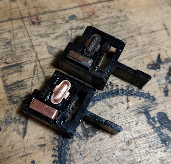

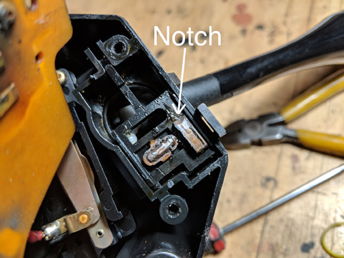

An addendum: the squarer contact develops a notch in the front edge where it runs into and over the button contacts on the PCB. If you turn the contact around, you'll get another 25 years of service out of it, and the switch will feel like new!
Here's the nasty old carriage (upper) and a clean one with the contact reversed (lower).
