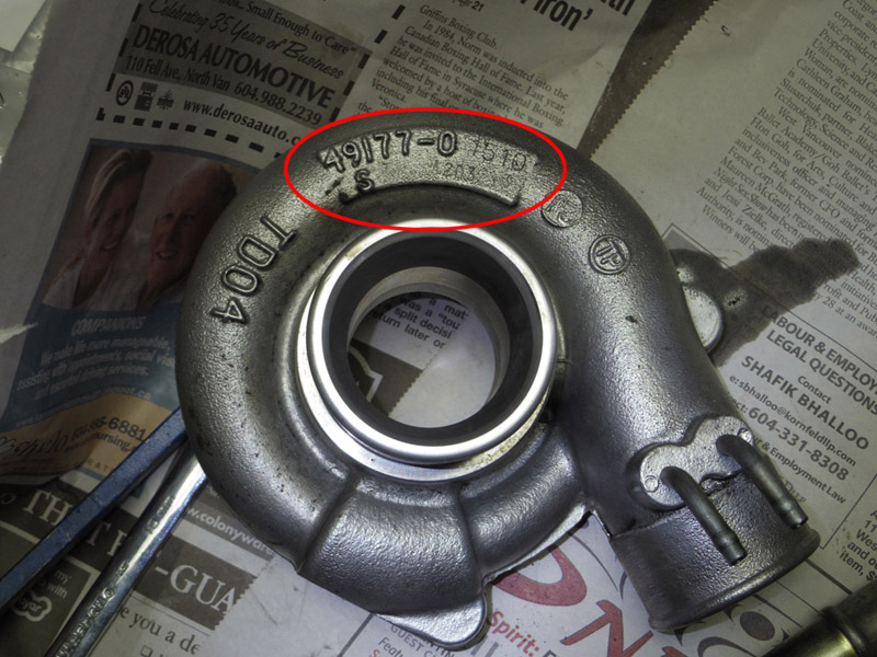

Hi Fred,
I just went through this, and all turned out well.
Glad to say that my turbo doesn't leak anymore, the process was relatively straight forward, and Rattlenbang's instructions make it much easier. The best thing for you to do is read the "turbo tag" which is a stamped number on the turbine housing. The number faces the front of the vehicle, but the downside is that you have to remove the drivers seat in order to read the tag.
Mine is a 1993 L300 4D56T, oil cooled and a flatback same as the OP: http://cgi.ebay.com/ws/eBayISAPI.dll?Vi ... 1114253451
and my turbo tag number was TD04 49177-01510 which matches the sellers description.
Unfortunately, I had to order a new cartridge. Not because I really needed it, because I could have recycled the old one, but because I whacked it too hard with the hammer trying to get it to press fit into the exhaust manifold and chipped it. Doh! Should have taken the extra 10 seconds and reached for the brass drift. Ah well, these things happen. Ended up getting a cartridge from Nerings, an ebay seller. Difficult to tell the quality but they claim to balance their turbos before sending them out. So far so good, and I notice the difference in performance. No leaks! http://www.ebay.co.uk/itm/Turbocharger- ... AQ:GB:1123

Not necessarily... I used some paper towel to clean up the side, crawled underneath and used a mirror :-0Tojo wrote:The best thing for you to do is read the "turbo tag" which is a stamped number on the turbine housing. The number faces the front of the vehicle, but the downside is that you have to remove the drivers seat in order to read the tag.
Thanks for the extra info, now I can order the part in confidence!

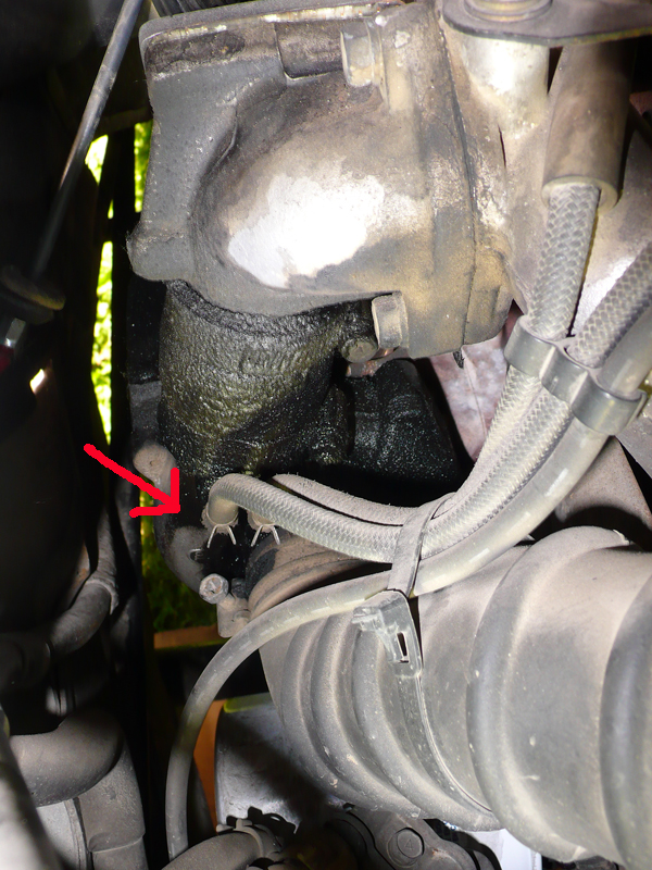

Alright! Got the parts and ready to do some micro surgery!!!
Now here is what the top part of my turbo looks like (Before I remove it all tomorrow).
Does this look like it is a leaky turbo to you? It seems like some new leaking oil come from those 2 small hoses. But I wonder how the rest of the older oil accumulate like that over time.
When I moved it earlier to the surgery room, I could here the high pitch sound that a turbo is suppose to make. So it still working. But I hope that with this kit it will stop leaking.
Fred

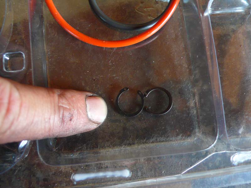

Now here is my question.
I have not seen these 2 small snap ring anywhere... did I missed something? There in the kit, but not to be seen anywhere during the laborious process of removing all the turbo parts.
Any suggestions?
Any suggestions?
- Small Snap Ring.jpg (79.03 KiB) Viewed 6890 times
-The Mighty Yeti
-The Mighty Yeti
- Tojo
- Posts: 185
Re: TD04 Turbo rebuild
KABOOM! Turbo is gonna explode dude.
kidding, I didn't use them either.

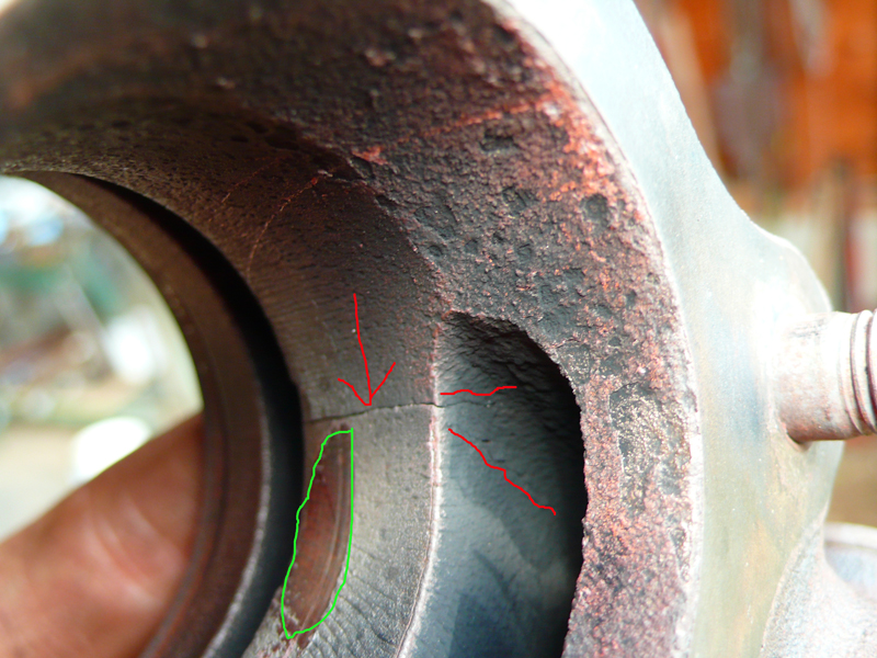

Well sorry guys but I need your help again.
I have been putting back all the pieces together and I found out that the turbine is rubbing the inner-part that goes onto the manifold. Cannot figure out why beside the fact that I have removed all the gunk but really it does not make much sense. So I have been looking carefully and found out that it use to rub on the side (see photo with green line) and also found that crack (red arrow and line following the crack all the way down).
I guess right now I'm screwed and have to get either a new or refurbish part.
Any thoughts on this one?
- DAMIT.jpg (459.27 KiB) Viewed 6877 times
-The Mighty Yeti
-The Mighty Yeti
Rattlenbang
- Posts: 647
- Vehicle: delica
- Location: Victoria
I'm not sure that the housing needs replacing because of a crack, it doesn't move or anything. But if your turbine was rubbing on it, the turbine will be worn. I would try to figure out how or why it's rubbing first of all. If the housing is warped, the whole shebang needs replacing, but if not you can buy just the turbine. I can understand how worn bearings will allow the turbine to rub, but with new ones in there it shouldn't if everything is installed correctly.
