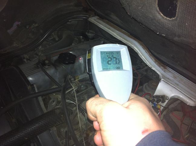

It fired up on its own for it's programmed 2hr run.
I found my spot temp gun thing, so.. after one hour I lifted the hood..
- temp1.jpg (45.45 KiB) Viewed 5502 times

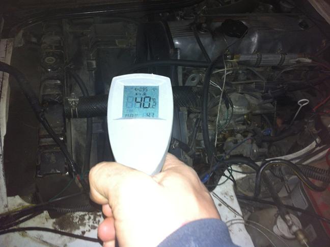

..this is the temperature at the top hose..
- temp2.jpg (44.11 KiB) Viewed 5502 times
.. the temp at the head..
- temp3.jpg (41.61 KiB) Viewed 5502 times

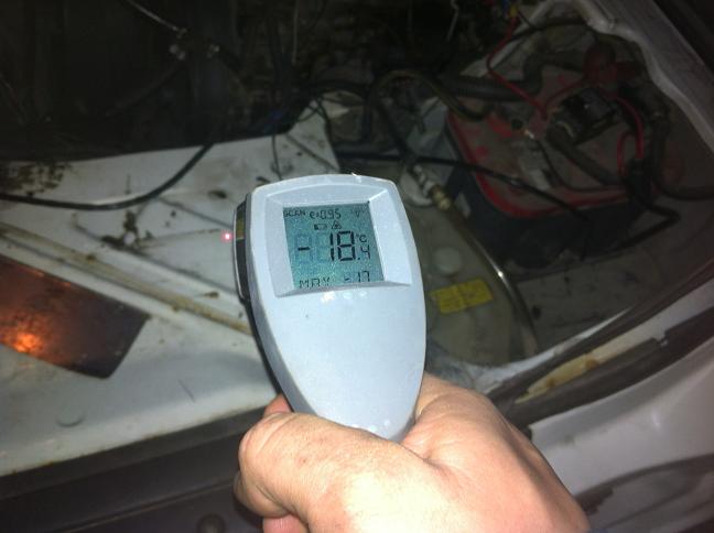

.. for reference the temp on cold metal beside the engine.
Remember this is not plugged in.. no block heater nor oil pan heater. Just the espar doing it's thing.

In the short amount of experience I've had with my heater.. I don't think it could be an effective cab warmer.. especially with the size a delica's cabin.
So far I havent seen the espar get the water temp gauge up into the green.. remember when I used my heat sensor gun gadget thing the best temp I saw was 40C. That won't get the cab warm.. unless it's being used for a BC 'winter'.
