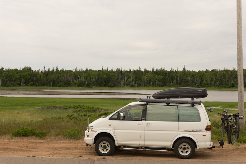

I'm over 14,000kms into a cross Canada road trip. The van's been converted to a sleeper (storage underneath the bed)...we have a cargo box on top, a swingaway bike rack (which is relatively heavy) with 2 bikes on it on trailer hitch, and an ARB awning...no idea how heavy it is but as you can see in the pic it sags quite a lot.
What are the pros/cons to air bags vs stiffer suspension? With air bags, would they be deflated when the van is empty and inflated when full? How do they inflate/deflate (I'm guessing a switch connected to a compressor or something?)?
Thanks!
