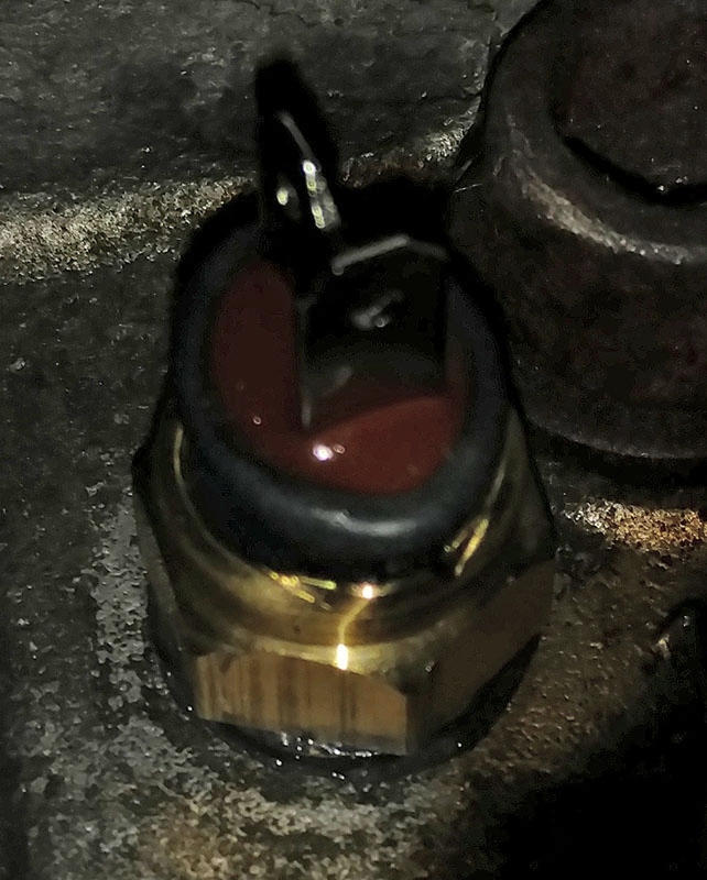

Got the sensor today and put it in. There seems to be a very slight gap... It's cranked down as far as I'm comfortable going. You think that's OK, or should I crank it more? What's the "spec" on this anyway? Where would I find that?

Cool! Does it work?
Workshop manual says 35Nm which isn't all that tight. The thread is tapered, so it shouldn't go all the way in before it stops anyway. If you overtighten it you can crack the housing.

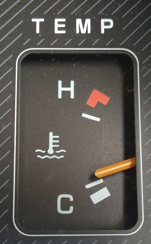

Well it moves. A tiny bit. Hm. What's next?

So this is what I'm getting now that I've replaced the sensor. Kind of what you're talking about @Lapprentis.
2016-05-27 18.18.23.jpg (289.64 KiB) Viewed 6906 times
So, EGT + multiple better temp gauges will be installed shortly. :D
Unless anyone can anyone think of another reason why this is happening to @Lapprentis and I?
Re: Temp sensor/gauge not reading
That's pretty normal for just idling, marginally low for driving around town but still ok. On the freeway on a hot day mine might even get as high as a third of the way up! Towing on the freeway might get to half, and it'll only go above half when I'm powering up a long steep hill.
But anything above the 2nd mark is good. All temperature gauges are slightly different, the trick is to get used to yours so you can recognise when it's doing something unusual.
A torque wrench is a really good idea. The digital ones are great if you use them regularly, but if you're on a budget one of these http://amzn.com/B0019VMI0Y will do just fine too. The torque wrench is mostly about learning what correct torque feels like.

That's where mine sits at idle now, maybe a half a needle width higher and around the 1/4 mark during normal driving. I had the same concerns as you when I first got my Starwagon last fall. I changed the thermostat twice (the first one stuck closed after a week) and the temp sensor. This appears to be normal for these engines. Needle was slightly lower overall before replacing these components. At least now I have a new OEM sensor and thermostat, so I should be good for a while. Oh, and a new rad cap.
Here's 20 minutes of driving in city street traffic. It took about 4 minutes to get above the 2nd line, then another 8 minutes to get to here. Then stayed about here for the rest of my drive.

You seems to be All Set now as for that Gauge. Now, as said before, if you want to spare your engine from overheating while climbling up a hill /and/or strong headwinds, and adjust the amount of fuel through the Gas pedal, the EGT is the way to go: the dash gauge will be of NO help in that..... :shock:
