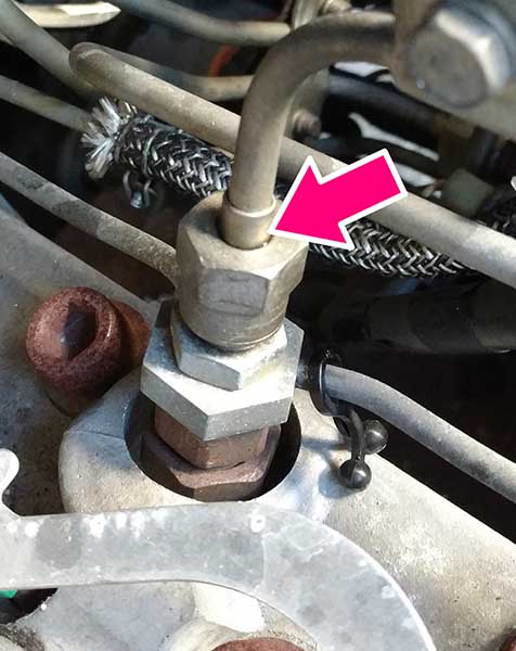

So I was able to loosen an injector and turn it over. There was a little bit of fuel spitting out from the top (see pic). What does that mean?

If there was normal fuel delivery the diesel would be practically flooding out. When bleeding the injectors you normally have to wrap a rag around the injector to stop diesel from getting all over the engine, and even then it gets everywhere. That doesn't look like enough diesel to me- I'd expect the whole injector to be wet after 5 seconds of cranking. That looks like a bit of fuel that was left in the lines weeping out.
TL:DR; as long as that picture is taken after 5 seconds of cranking I'd say you're not getting normal fuel delivery. Solenoid replacement time!

I did wipe it up a bit, but there definitely was not a lot... Just spitting a bit.If there was normal fuel delivery the diesel would be practically flooding out. When bleeding the injectors you normally have to wrap a rag around the injector to stop diesel from getting all over the engine, and even then it gets everywhere. That doesn't look like enough diesel to me- I'd expect the whole injector to be wet after 5 seconds of cranking. That looks like a bit of fuel that was left in the lines weeping out.
OK... So now... Who's got a walk-through for solenoid replacement? :D

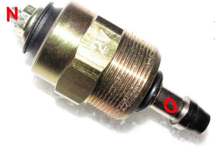

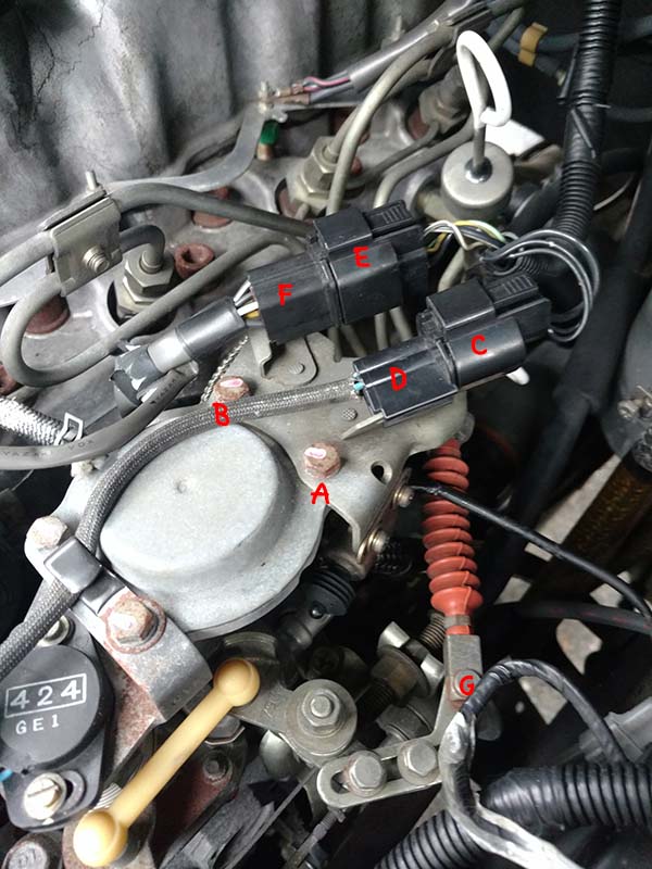

I finally received the new fuel solenoid and was able to get it installed. Haven't had a chance to reassemble everything, so I'll update once I have a chance to do that and see whether it gets the 'ol Deli running or not. Fingers crossed. I'll do a little walkthrough of how I did it, some things to think about, and post some pictures. Growler can tell me what I did wrong.
1. Stuff a few rags and maybe an oil pan/large flat piece of cardboard under the vehicle. There will be fuel leakage. I didn't do this until it started leaking.
2. Remove the top bracket holding the wiring harnesses. I unplugged C from D, then E from F, then disconnected F and D from the bracket. I took out the cotter pin at G, then unscrewed A and B. YMMV

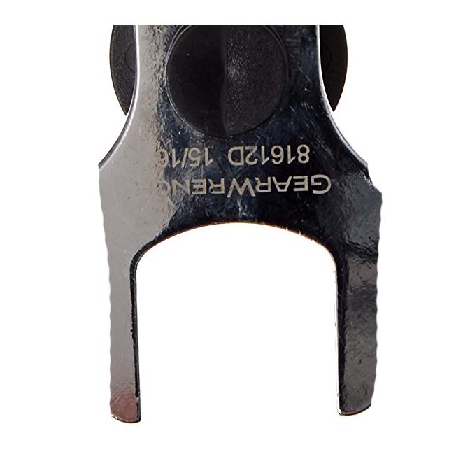

3. Get a 15/16" clawfoot wrench. I also think a 24mm would work. I just took a caliper to the new solenoid and got that measurement. The 15/16" worked great. Ultimately I didn't need much torque to break it free, and didn't apply too much torque reinstalling it. None of my local stores had it, so I ordered this one: https://smile.amazon.com/dp/B002YKI7ZE
No regular wrench fit and the clawfoot worked famously. On another note, my VW diesel mechanic said that he's had to replace/rehab more than one fuel solenoid and he actually ended up getting a really cheap wrench and grinding the sides down as pictured. I used Photoshop, but he said it helps him get the job done when it comes up. I didn't have to grind mine down.
4. Disconnect the solenoid trigger wire and remove the male trigger from the bracket. More below. I separated H from i and J from K, but in hindsight, I may not have needed to disconnect J from K. Just pushing J/H down worked. To get the hood (M) off, I used a wire coat hanger with a hook on the end. I also destroyed the old solenoid in the process. I may not have even had to remove the hood/trigger wire assembly (M,N, H), but it came out a LOT easier without it. As I unscrewed the solenoid, the trigger assembly was getting squeezed up against the thingy above it (P), making removing difficult. In hindsight, this may have actually broken the solenoid. Who's to say? I had to solder a new metal o-ring connection to the end of the trigger wire to attach to the new solenoid at point N.
5. I did my DAMNDEST to unscrew L to no avail. Finally I bent "i" down out of the way just enough to get one turn at a time from the clawfoot wrench, which was enough. Once the solenoid came loose, fuel started to leak. The bottom part of the solenoid (part "O") was stuck in the solenoid well and required a hefty heave-ho with some needle-nose. I'm optimistic that this was the problem!!! We shall see. I should ad that I needed a 10" 3/8" ratchet extension to break the solenoid free/torque it down. There is NO room to work here!
6. I reinstalled the new solenoid following the reverse procedure, the reattached the solenoid trigger wire (part "N") after the solenoid was screwed all the way back in.
This is as far as I got before running out of time. I just need to reassemble everything, then give it a whirl. Now... I'm assuming I should bleed the injectors before trying to start her up? Anything else to consider? Do I even need to bleed them?
Another question: What's with the pink? I think I understand, when you take something apart and reassemble it, you want to match the torque/placement, but what's the point of painting part "L" for example?
To be continued...

Great writeup! It shall be immortalised in the Technical Reference Library. Eventually.
You might not need to bleed the fuel lines, but if it starts and only runs on 3 cylinders then try bleeding the one you opened earlier when testing for fuel flow.
I don't see any issues with how you did it. The pink marks are put there when the pump is rebuilt- you mark each bolt when you've torqued it (so you don't forget to torque anything) but afterwards the marks let you know if anything is coming loose- if the marks don't line up, something has moved. It's the sort of thing engineers do, so I suspect the IP has been rebuild by a conscientious diesel shop at some stage. Is there any other pink writing on or near the engine?
Fingers crossed it starts. The stuck plunger sounds promising, it would be a shame if it didn't work after all that effort!
