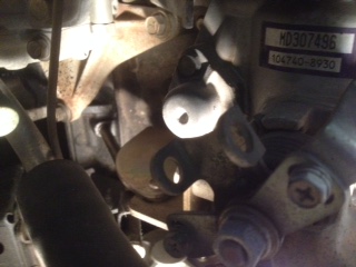

Post by Ralph in Winnipeg »
Thanks for all the input, I really appreciate it! I looked this morning but did not find where the advance plunger is on the IP. I remember reading it needs to be set with a dial indicator which I have but.... Could someone point me in the right direction / diagram please?
I will get the truck back in order tonight and see if the timing adjustment did the trick but I want to prepare for other possibilities.

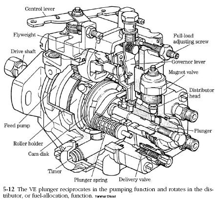

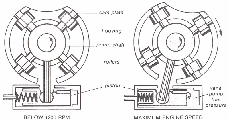

There are two plungers in a VE pump- the timing advance, and the injection/distributor plunger. If the timing advance plunger was stuck it would cause your symptoms.
The advance plunger is labelled "timer" on the first diagram, so I'll call it that for now. Its function is similar to the ignition advance on a gas engine- fuel takes a fixed amount of time to burn regardless of engine speed, so when the engine is running faster you need to inject the fuel a bit earlier to give it time to burn fully before the exhaust valve opens. As engine speed increases, increasing fuel pressure in the pump pushes on the timer, which rotates the roller holder so the rollers hit the high spots on the cam disk earlier. Like this:
Incidentally, fuel pump internal pressure is controlled by a tiny orifice on the pump outlet. Thicker fuel will increase internal pump pressure, which would advance injection timing more- which is odd, since your symptoms imply *retarded* injection timing. Which is why I think the advance plunger might be stuck. Maybe the engine oil loosened some sludge that straight diesel didn't touch?.
The injection/distributor plunger is the bit that creates the high pressure for the injectors. Initial timing setup is done by measuring how far it has moved when the engine is at a certain angle (1mm at 9 degrees, on your engine, from memory). Actual setting procedure should be in one of the workshop manuals. I doubt your issue is caused by incorrect initial timing, but if you remove or rebuild the injection pump you'll probably need to set your initial timing.

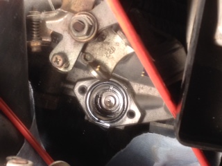

Purge made no difference, oh well. I removed the timer cover,
and I see the plunger.
I pushed it with my finger and it did not move at all. How far should it move? Are we talking thousands of an inch or a few millimeters? There is a snap ring visible in the picture that I could remove and then the plunger could move toward the opening? Taking a break for now......

It moves a couple of centimetres at least during normal operation. You are pushing against a spring and the cam gears so it won't move freely, but I wouldn't have thought it was *that* hard to push. Disclaimer: I've not actually done what you're doing, so I'm guessing how hard the plunger would be to move. I can't think of any reason why it *wouldn't* move though.
I would try removing the snap ring and see if the plunger moves outwards at all. It may be that a small amount of movement is enough to free up whatever is holding it in place? It shouldn't be able to come out entirely since you have to dismantle the interior of the pump to get at the timing pin (steps 23-36 in the rebuild guide).
A couple centimeters! I should notice that! Could it be fluid behind the plunger holding it firm? I'll try to loosen the cover on the other side let the pressure off and see what happens. Now going out with the lads to try a few of the new beers being made here in Winnipeg at some start up breweries and not think about the IP. Well they're motor heads too so we'll certainly discuss it and then move on!
I wasn't able to push the timing plunger but I could pull it. I did not remove the snap ring as I apparently don't have snap ring pliers small enough to get in there. It moved freely back and forth so I moved it 20-30 times and put the cover back on. Truck felt better last night but I'm going to have to take it for a good drive tomorrow when I have time. Fingers crossed.
