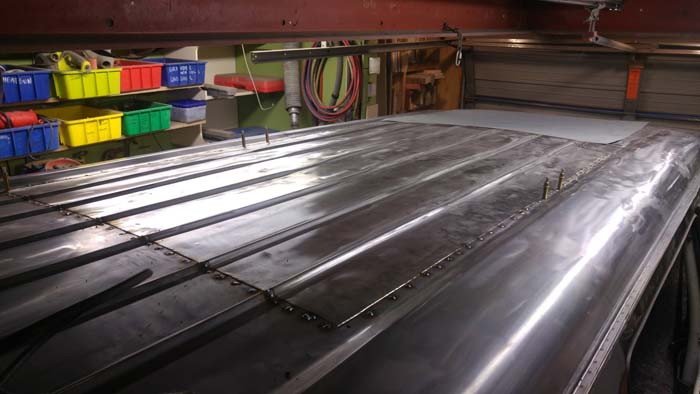

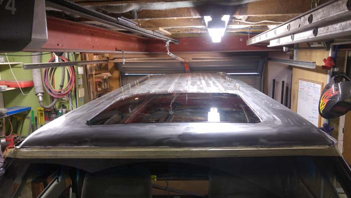

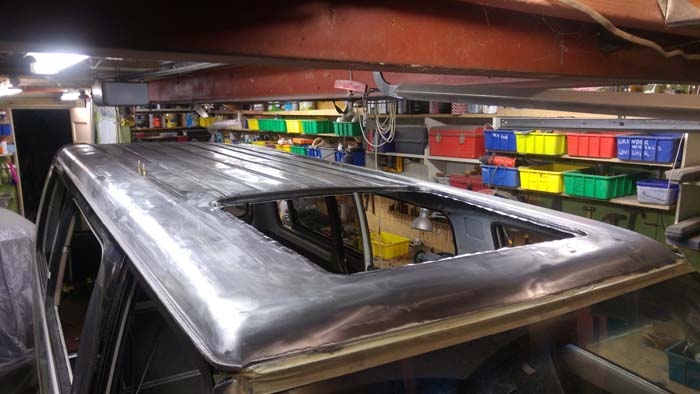

And we're making progress: the new roof panel is fitted and welded in place. It doesn't look like much work, but it's taken 3 days and the workshop is a mess.
Everything aligned and held in place with Cleco temporary fasteners:
Rather than a proper butt joint, I'm making a joggled lap joint. It's a bit amateur and can create a rust trap if not sealed properly, but the roof panel is incredibly flimsy and a butt joint would create more distortion than I'm willing to deal with.
Plug welds along the seam:
Grind the welds back until everything is smooth again:
Now I just (just!) have to prime everything, reassemble with panel adhesive, and then I might be able to install the glass and then paint it.

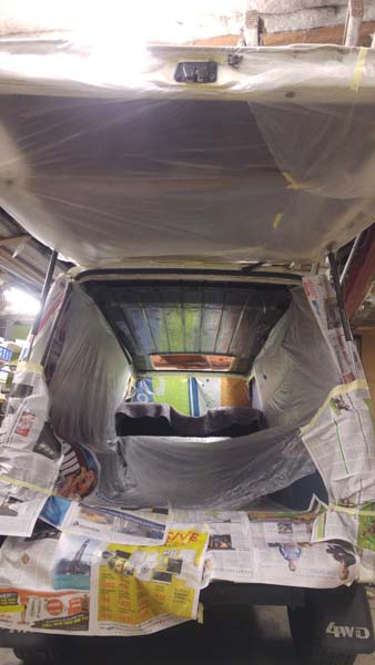

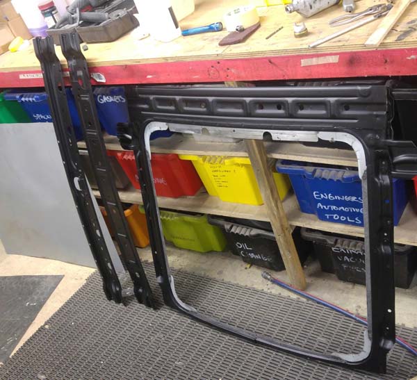

All scrubbed, masked (with newspaper because of course I ran out of masking film), and primed with epoxy.
20170624_144755 copy.JPG (46.42 KiB) Viewed 11955 times
20170624_171113_HDR copy.JPG (45.84 KiB) Viewed 11955 times
Now we let it cure for a day or two, and then glue in the roof bows and other structural bits (which are also primed and ready to go)

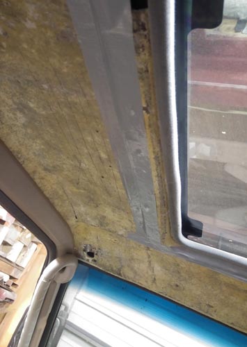

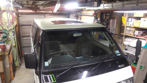

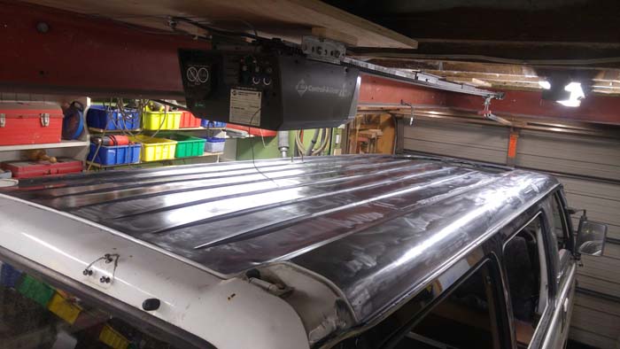

Roof bows and glass support frame are all in place, and the glass is finally installed. In theory it's watertight and driveable now, though it's still not pretty.
20170628_163741_HDR copy.JPG (53.49 KiB) Viewed 11916 times
20170628_163726 copy.JPG (59.16 KiB) Viewed 11916 times
20170628_163652 copy.JPG (67.95 KiB) Viewed 11916 times
20170628_163636 copy.JPG (73.95 KiB) Viewed 11916 times

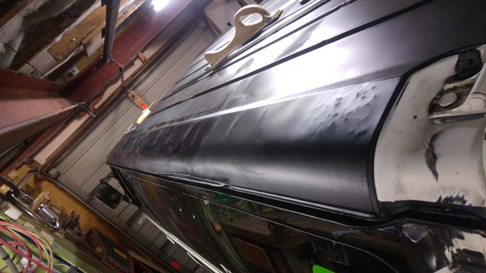

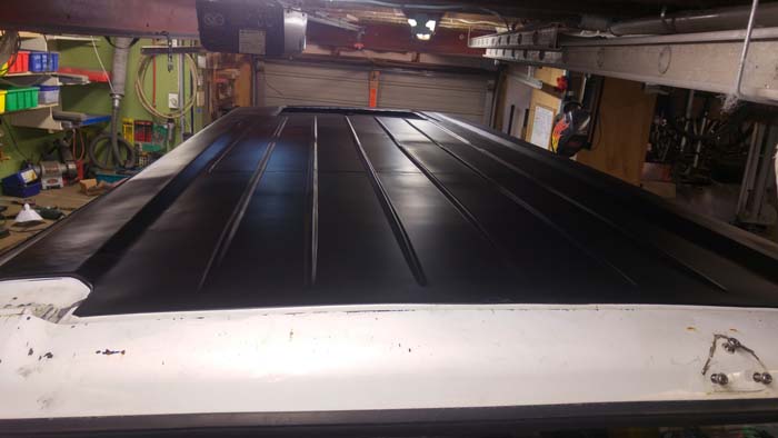

Matte black primer hides all sorts of nastiness, but a light application of the longboard sander shows up just how much work I have ahead of me before I'm able to paint it:
20170628_174041 copy.JPG (59.16 KiB) Viewed 11916 times
The new piece of roof is nice and flat, but the old roof has lived a tough life.

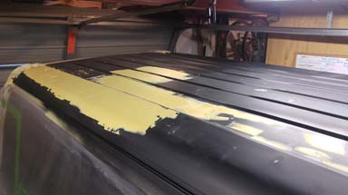

The work is not feeling particularly awesome right now. This has been my life for the last 5 days:
20170703_112400 copy.JPG (27.85 KiB) Viewed 11864 times
Ugh. Using filler feels like defeat, but this roof panel is just ridiculously flimsy. You can dent it with your thumb. Shrink out one dent just a fraction too far and another pops in a foot away. Shrink out a large dent and you change the curvature across the whole roof, which makes the ridges look like buckled train tracks.
I'm nearly at the point where my irritation exceeds my standards, which means it's almost time for paint!

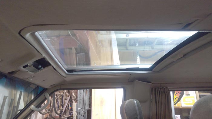

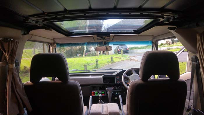

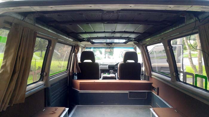

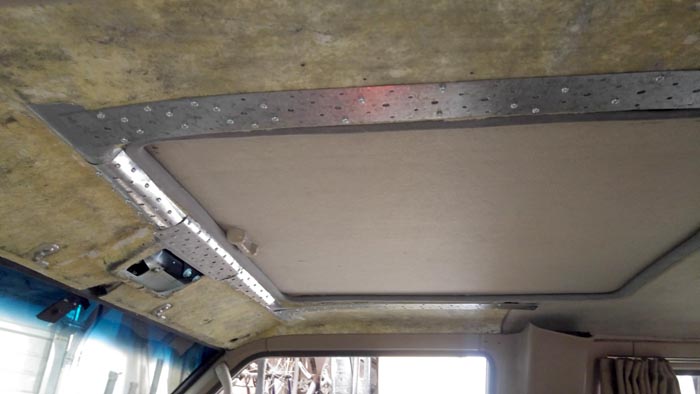

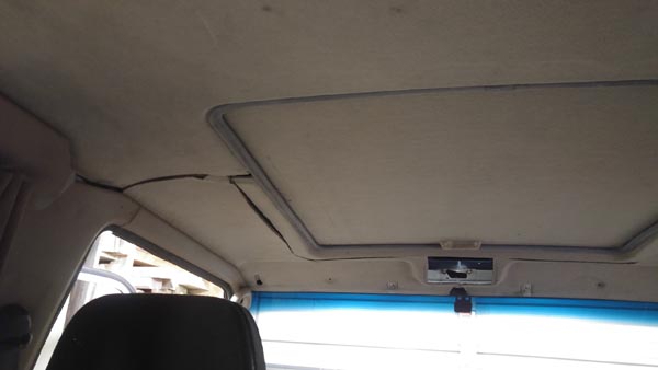

Not pictured: fitting the sun shade. Basically, I took the old sunroof mechanism, removed anything that wasn't needed any more (motor, sliders, massive steel brackets) leaving just the sunshade, and screwed that to the inside of the roof. More pictures later.

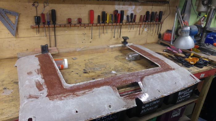

I'd previously measured the roof lining, and it looked like I could reconfigure it to make it work, rather than having to make a whole new liner from scratch. Time to find out if my measurements were correct...

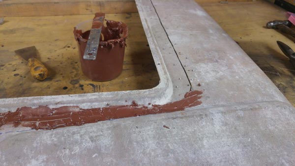

Hey! Not bad! Right. Duct tape first, to hold the fibreglass in:
Steel plates to hold the edges in alignment
Fill the gaps from behind with chocolate frosting... errr, epoxy with fairing filler
And fibreglass.
Neat! We'll find out tomorrow if it worked.
