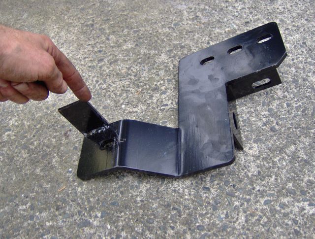

I installed it on my Deli but it wasn't a straight fit as I was told. The attachments interfere with the rear sway bar so I had to trim some metal (1/4" steel, fun!) Aside from that it worked out fine and I still like the design.

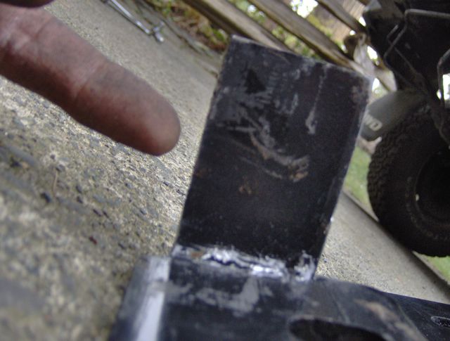

I'll try to get pictures for you but it's the "horizontal" plate that sits below the frame and butts against the torsion bar receiving plate and bolts. I had to trim about 1/2".

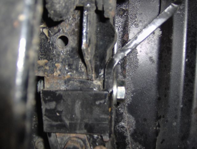

OK, I just got in from "bolting" in my M-drive hitch and have to thank delicat for the heads-up on the required modification. Easier to deal with such things when they are expected. And if I didn't have a couple of frozen bolts and a hacksaw-drill-easyout show to contend with as well. It's in and ready for the work trailer and bike rack now though, whew. Here or a few shots of the flange that needs the grinding... Have fun out there!
- This is the trouble bit
- hitch2.jpg (79.87 KiB) Viewed 7815 times
- Ground down and ready to bolt on
- hitch1.jpg (45.95 KiB) Viewed 7822 times
- note the flange plate at the very bottom of the picture, just above the half of a bolt.

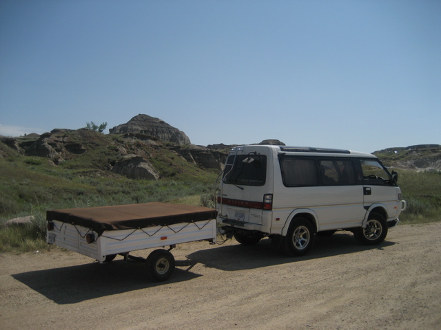

no complaints from me. It does what it should, and it was an easy install. Make sure the mod is done to the hitch before you take it - it should only take them a couple minutes if they haven't already done it (call ahead). I regularly pull a utility trailer, and have loaded it up with as much as 1.5 yards of soil. I also pulled a tent trailer over the rockies. I think the hitch can take a lot more weight than you would want to pull with a delica. Even with the most basic tent trailer, I was being passed by almost everyone, even tractor trailers. I don't have much use for the extra receivers though. Unless you have very specific needs, I can't imagine needing more from a hitch.

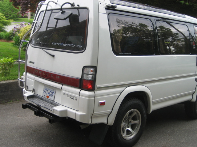

Not to change the subject at all, but I noticed that the sliding door is on the right hand side on this blue Delica as opposed to the left. I also noticed the "CMC" on the back as opposed to the "MMC" on ours. I'm simply curious to discover where this Deli is from and if they are being imported?mdrive wrote:just received some more photographs of the actual hitch installed. Towing Capacity with trailer brakes 4000-4400 lbs, without trailer brake 1700 pounds in 100 kmph.
