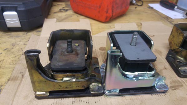

And the final touch: new drivetrain mounts all round. The old engine mounts were badly collapsed, the transmission mounts had splits, and the upper transmission mounts were very saggy.
New mounts have made a huge difference. No more knocking noise when turning the engine off, vibration at idle has almost disappeared, as has the slight shudder on takeoff. :-D

That's some inspiring stuff GBNZ :-D . It's crazy to see how much those old motor mounts had compressed. How long do think this swap has taken you from start to finish?
