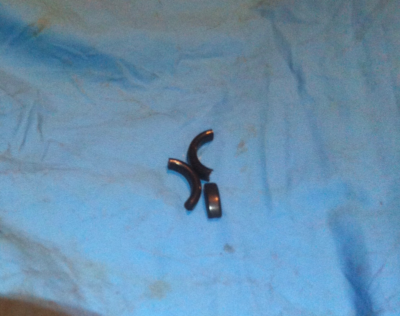

Fingers crossed the re-seal will make an improvement. this is what the bottom pressure regulator o-ring soon looked like: Very brittle and loose, although still intact, after pulling the regulator. I replaced all the rubbers in cluded in the kit. And am reassembling with cam seal, belts, tensioners. At negative 20C. Bleck.
Wondering about the motor, also. If I had the replacement pump that came with the van I'd be trying to build the best pump with what I have. But since I don't know what the other is like entirely, I've opted not to invest in this one until I do. I've been informed that bushings are not readily available. I'd be happy just to have a working van again at this stage, even if I have to wait for warm days to start it. I'd rather invest in injector work.
