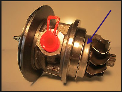

I have a bit of a whine to my turbo which perplexed me until I took the beast apart. My heat shield doesn't seal properly due to lots of corrosion so it vibrates causing a distinct whine/rattle. I live with it.
Screen Shot 2018-10-15 at 7.11.18 PM.png (188.91 KiB) Viewed 3863 times

I'll have a look at that when I swap in the new one. If it all looks ok I'll have a spare.
