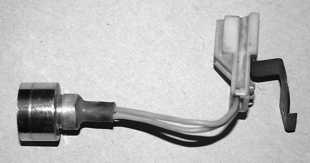

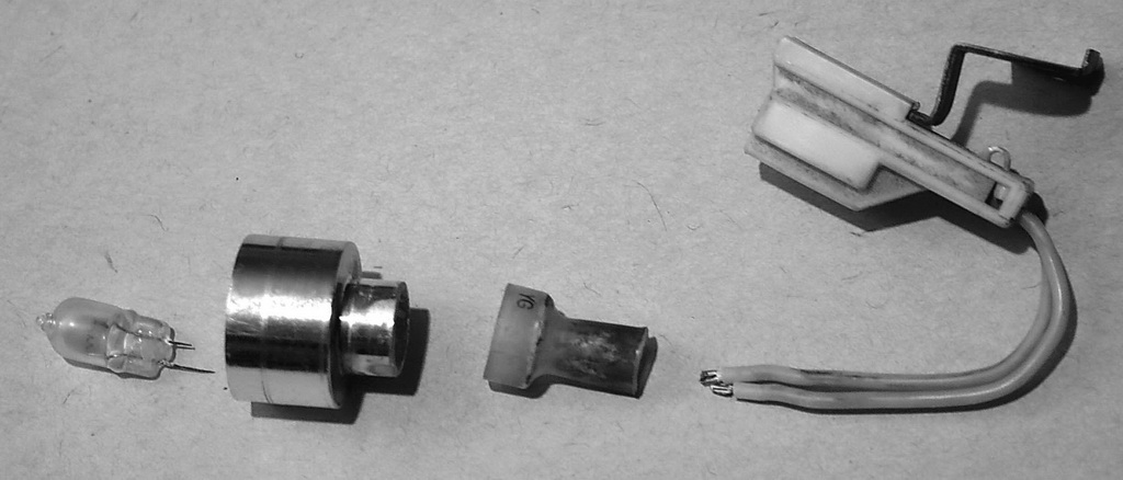

The original assembly taken apart.

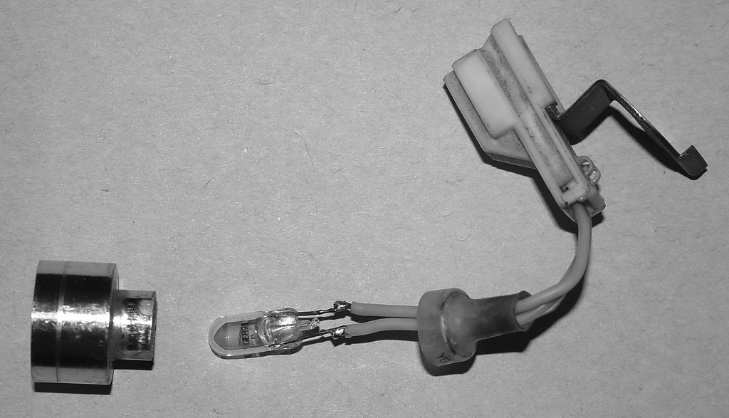

The replacement bulb soldered to the wires.

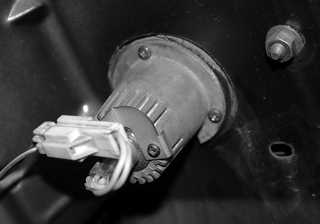

The assembly is mounted back to the tail gate.

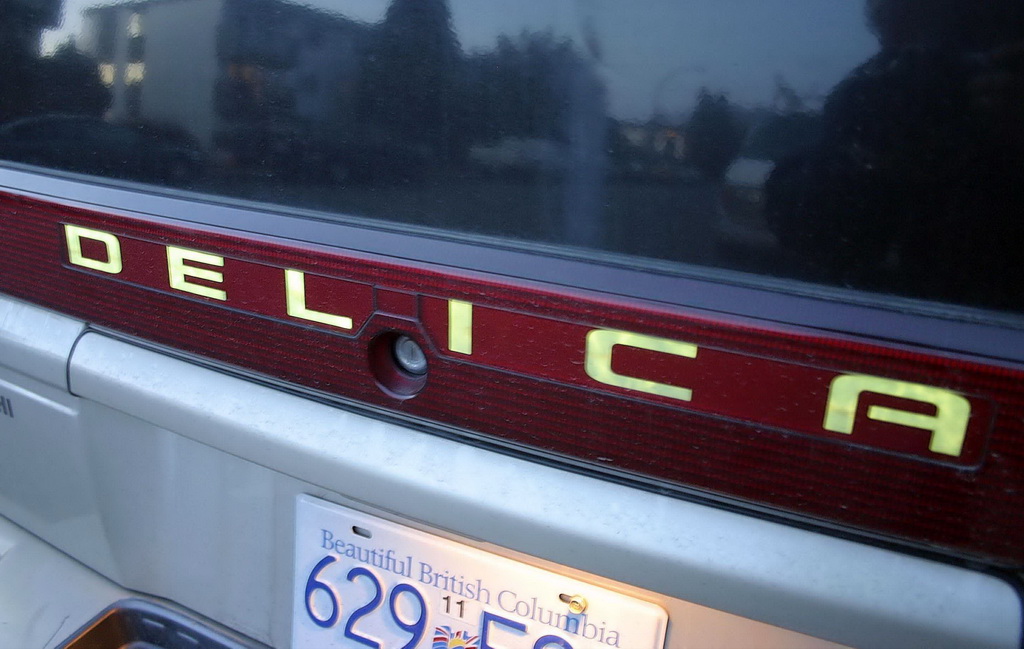

Now it is DELICA, not ICA!

I was instructed on the UK site to remove only the single rear screw, in order to remove the bulb holder and leave the bigger unit attached. Does this seem correct?
--T
'91 Exceed
Nimbus 2000
Re: Tail Gate Lights
torchard wrote:I was instructed on the UK site to remove only the single rear screw, in order to remove the bulb holder and leave the bigger unit attached. Does this seem correct?
--T
Yes, that single screw holds the bulb in place with a locking arm/plate. If you unscrew the complete holder (the three screws), then you can clearly see the ends of the fibre optic strands. The bigger holder contains the lens/prism which focuses the bulbs light into the ends of the strands.
