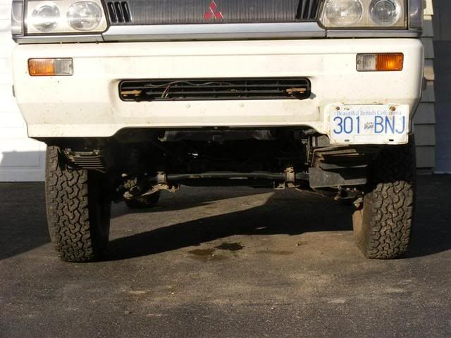

1. the brace for the motor mounts has to be modified so the front drive shaft does not rub - expect 2+ hours remove and reinstall and 3-4 hours to modify (cut, weld in pieces, paint) - see Gary's original post for his mod;

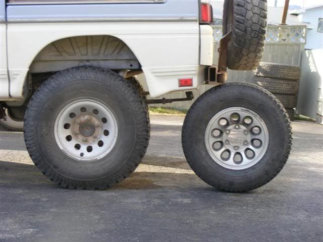

2. new off set rims - I haven't done this yet, but the upper arms have rubbed a groove on the inside of the front tires, when the torsion bars are cranked, the wheel moves in closer to the control arms and rubs (I'll try to get some pics later), and offset rims will give a lot more space, besides, you need wider or bigger rims to run bigger tires;

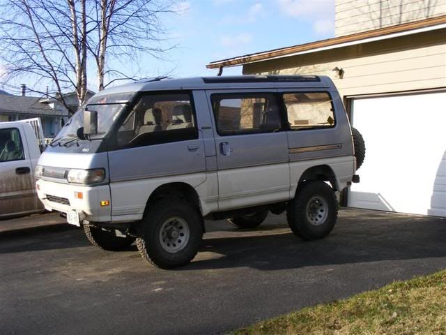

On the other hand, the ability to put 33" tires on is really cool (these are 33" x 9.5" x 15" - not mine I hope to run 235/85R16's):

Everyone seems to think that these vans are unstable. However, most of the weight (engine, transmission, t-case, differentials, wheels) and the center of gravity is below one's butt. With my lift and the big wheels and torsion bars (still can't say this enough about them) body roll is a lot less that it was previous. Josh can verify as he followed me from Smithers to Houston one day and was amazed at how quickly I could go into the corners with minimal lean. Also, when using offset rims the stance will be wider and a bit more stable yet.

The torsion bars came with my kit, there are only torsion bars on the front and they are specific for each side. I got a very good deal on the used kit from Glenn. I am happy with the quality and condition of all parts. I measured the old torsion bars, and they are 971 mm long, this corresponds with Ironman MITS017 torsion bar here:

I didn't have the money or the patience to consider what many of you (Doc / GaryO / Patty etc) have done or are considering doing. I went with American Racing wheels & 31" tires - with more negative offset than the Toyota rims most people use - cranked the T-Bars all the way - new 9000 series pro-comp shocks - trimmed the fender wells & removed front mudflaps - finished off with alignment. Still need to do a wee bit more trimming, but otherwise happy with the results. Total investment broken down;
Craigslist tires & rims - $150
Alignment - about $200 I think
And about 2 hours of my time trimming etc.
I'm happy with the result for $350.
