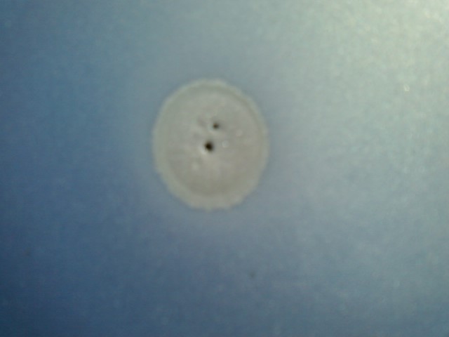

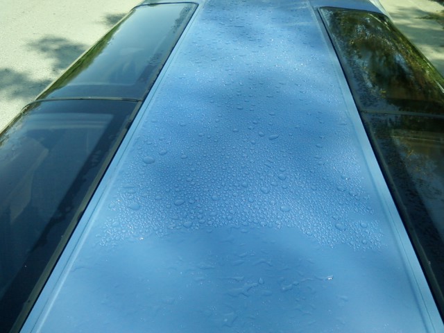

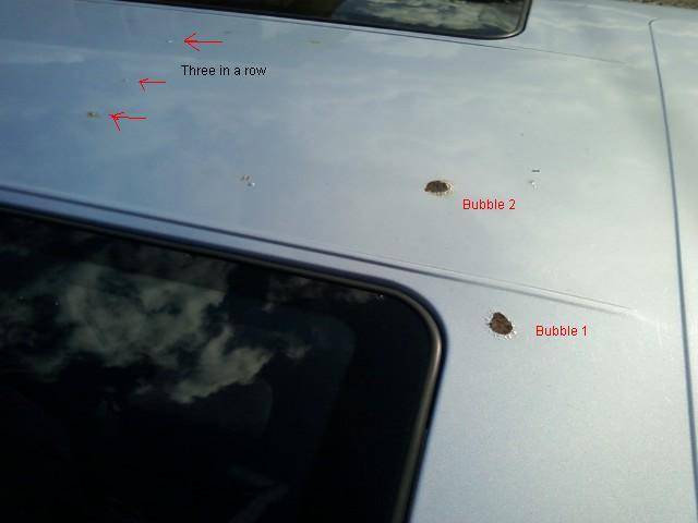

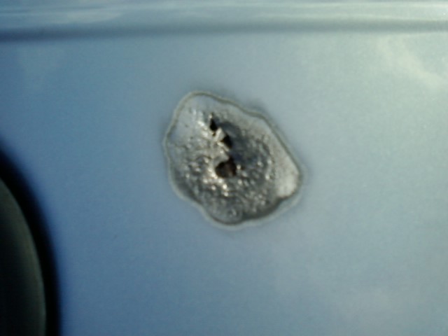

Some more pics from today.
I previously posted pics of the bubbles, here are more detailed ones.
bubbles.jpg shows the 3 in a row bubbles and the two larger ones better in context of their location.
bubble 1.jpg and bubble 2.jpg show the two larger ones after sandblasting.
pinhole.jpg shows one of the 3 in a row bubbles after sandblasting.
I sandblasted all the bubbles today. Most had pinholes through the metal. A few didn't.
I then filled with long strand fiberglass filler, sanded and smoothed out with fine spot putty.
I'll take more pics tomorrow after sanding the fine filler and before painting.
I've decide to just repaint the roof the original colour for now and clearcoat.
Some points of interest while sandblasting. The blue paint on the roof is very thin. There is a much thicker coat of a gray primer beneath it. The rust was creeping beneath the primer on the surface of the metal beyond where any of the smaller bubbles at the edges are.
As can be seen in the pictures the rust was growing and spreading on the surface of the roof beneath the paint. Seems it may well have started where the pinhole is, but it's growing and spreading on the outside. I would definitely say it has started where the spot welds let go, apart from the few that had no hole. It would appear that it is not spreading the same way inside. Hopefully this has to do with the type of coating on the inside as they are not concerned with the finish under there, just corrosion protection. Good for us.
Seems they expected the paint finish to protect the outside.

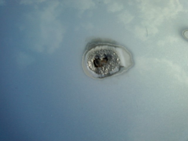

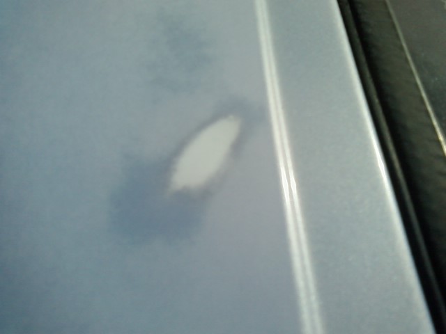

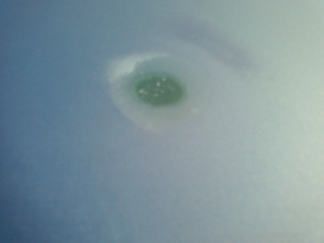

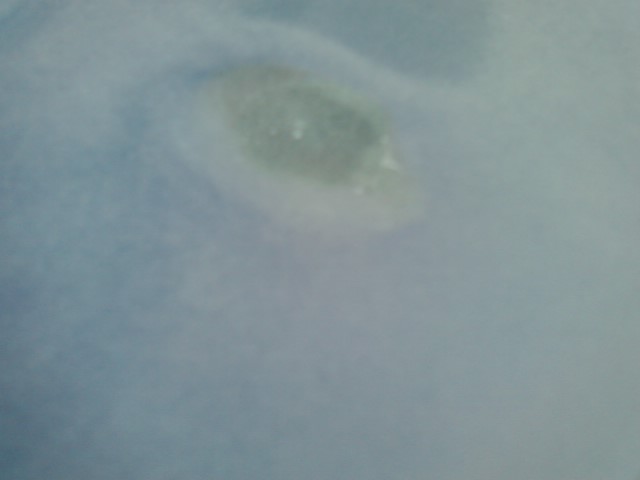

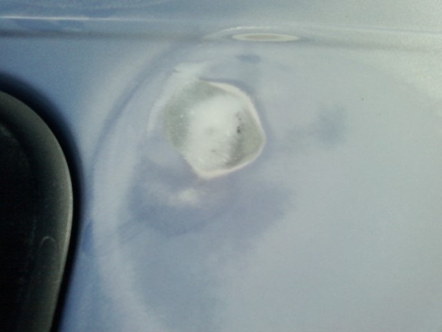

So now the holes are all filled, sanded, refilled, sanded, primered, sanded, painted. Looks like a new roof now and still have to do the clear coat.
You can see in the pictures how the filler just fills the dished out area that had been rust. No bare metal left showing outside the fiberglass. Very important to seal the bare metal. The fiberglass is absolutely water proof, no moisture will get at those spots from above. If it should continue to rust from below it will be a very long time indeed before it gets around those patches.
Sprayed some "Rust Check" into the areas where the holes were from underneath, especially the large ones in the front. Was only able to use the long red straw through the gaps around the big light, but the stuff creeps and spreads on it's own. It should help a lot.
Like I said earlier. It took 15 years to get this way, it's good for many years now.
I sprayed several coats of paint over the roof to give it a good heavy layer.
Once good and hard I'll sand with ultra fine 2000 or finer and do the clear as I didn't have a booth so have a few critters stuck to the roof.
Used commercial grade paint from my buddies shop, not spray bombs.
I'll post pictures of the finished product, looks like a new roof already.
Interesting Glen says the spots that let go were bonded with a glue type product not spot welded. I guess they cheaped out and only bonded spots instead of the whole strip. So wherever the bond let go it removed the anti corrosion coating to expose the steel.
Bob
small hole filled.jpg (38.55 KiB) Viewed 7899 times
other large hole.jpg (26.53 KiB) Viewed 7899 times
large hole filled.jpg (38.07 KiB) Viewed 7899 times
