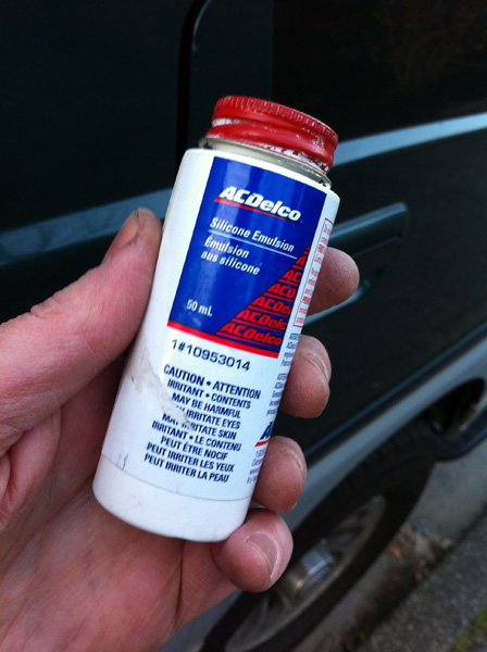

Here's a clearer photo of the Silicone Emulsion. I got it at Lordco. I had to order it from the main warehouse, and then I picked it up at the store:

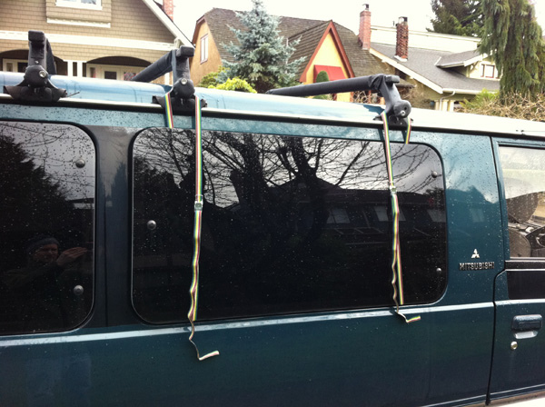

Here's the makeshift contraption I made to keep the windows from shattering on the ground after I took the bolts out:
...and I just swung the window up on the roof rack, while I was silicone-ing:

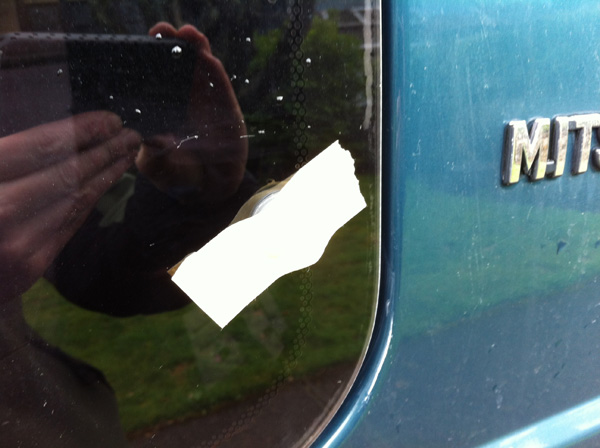

I found it useful to tape the nuts in place, so they didn't fall out of the windows:

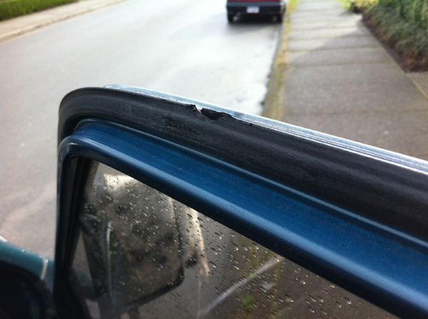

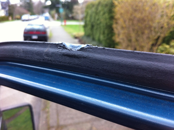

While I was at it, I applied silicone emulsion to the door seals as well, and found a rip above the driver's door:
...so I patched it with silicone (tub'n'tile, not silicone emulsion). Not a fantastic repair, but I concluded water wasn't coming in here, so it's just to prevent it from getting worse:

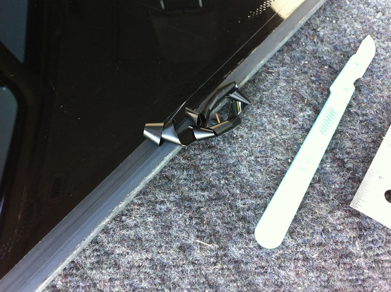

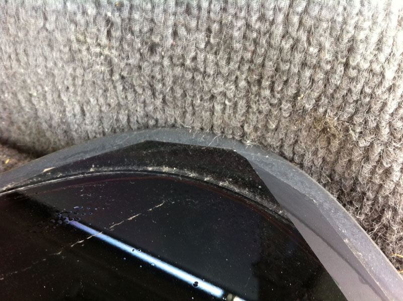

It turns out there was still some water getting in the side windows. This is because a previous owner (who shall remain nameless) applied window tinting film and didn't respect that the rubber seals need to contact that special, flat black material that's baked onto the edges of all the side windows. Yeah, that's been tested to seal nicely against the rubber, so when your tinting plastic crosses the rubber seals in a few places, that's where the water gets in. I'm sure no one else has this problem, but here's a few pics of me trimming the window tinting, so that it clears the seals.
We've had some pretty stormy skies this winter, and so far no wet dog smell.
BTW that flat black stuff around the edges is really hard. I was cutting the tinting film with a knife blade, and was being careful not to scratch it, but I don't think I could. I expect that black stuff is baked on during the manufacture of the side windows, and is some kind of ceramic.
