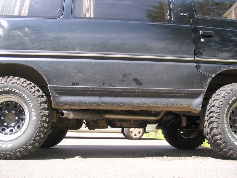

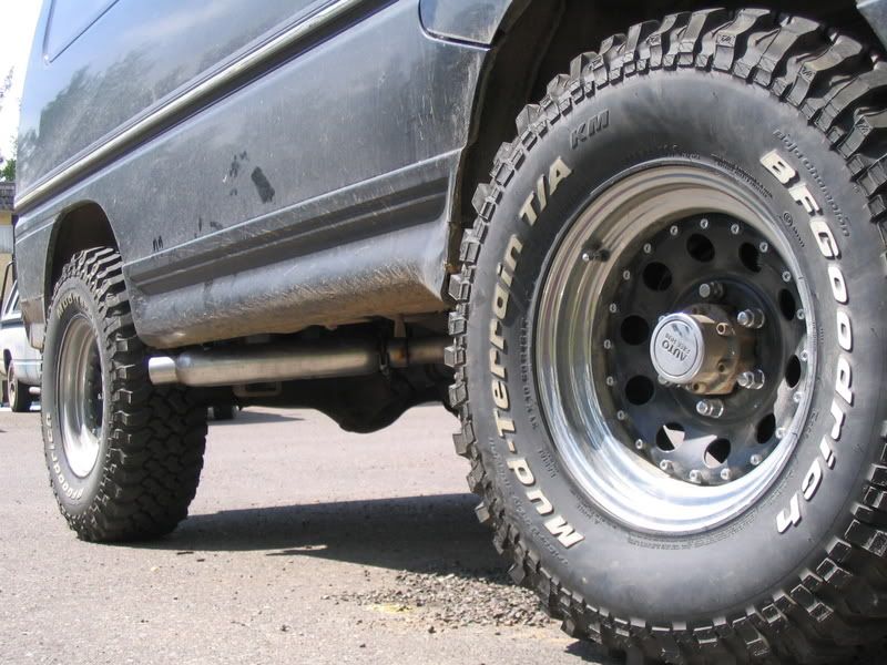

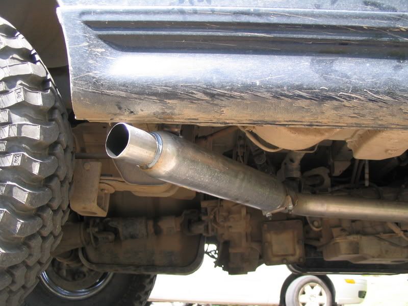

I just got a 2.5" exhaust too, but I got a cherrybomb slapped on the end of it before it exited the side. Cost just shy of $250 for everything. Has a real good rumble and a nice turbo whistle. Here's a few pics...
So what do you think? I like the fact I can keep an eye on whether or not i am blowing black smoke... and sounds like a real tractor.
Josh

Gee Josh, how much attention is your rig attracting now! Looks good. 8)
Did you put it together?

I got the exhaust shop to do the work... and it does seem to get noticed even more now! I sure enjoy it anyhow.
