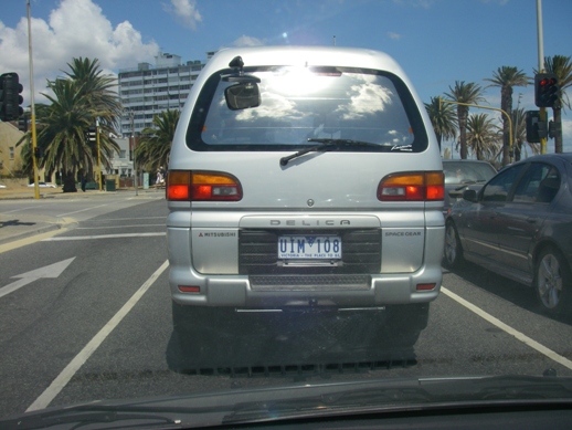

Saw plenty of L400 Delica in Australia recently, and they were all the same length – but still can’t decide for certain which length they all were. LWB?
Shame I didn’t get a picture of the two L400’s spotted with a spare secured above the front bars on the hood.

- My only L400 picture last week, they certainly look better in person.
- IMGP2126.jpg (118.14 KiB) Viewed 7648 times

if the middle and rear windows were the same length it's LWB, if the middle window is about twice the length of the rear window it's SWB– but still can’t decide for certain which length they all were. LWB?

Also if you look behind the sliding door between the door and the wheel arch.
If the door looks like it forms part of the wheel arch it is a SWB if there is about an inch or so between the door and the arch its a LWB.
