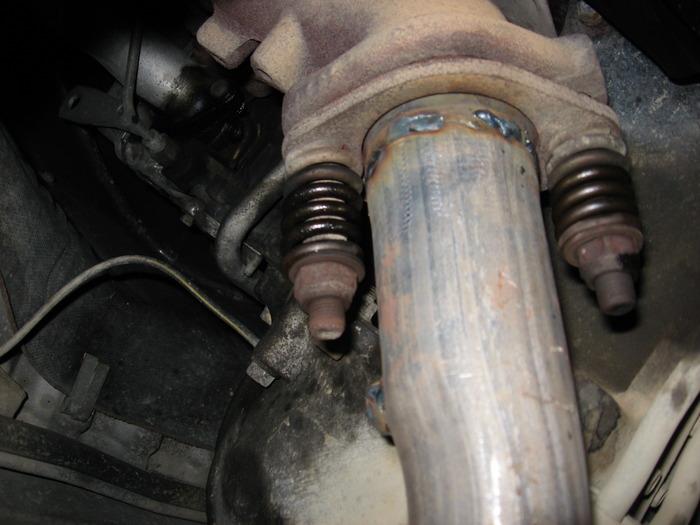

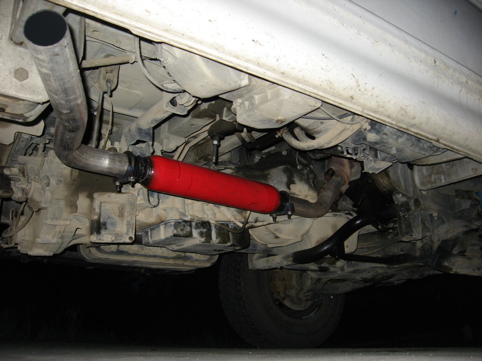

used the info in this thread to have a 2.25" exhaust installed on the cheap.
had the work done at budget brake and muffler.
asked them to reuse the old flange, and weld the new pipe as high as possible.
they also welded in a bung for pyro.
here's what $170 gets ya on a monday in courtenay.
$40 for cherry bomb
$130 for the install
I'm pleased, noticeable power increase doing hills on the way to vic tonight.
sounds more like a truck, and you can hear the turbo now!
cheers colby
$40 for cherry bomb
cheers colby
- can just see the pyro bung
- rsz_1img_1076.jpg (101.33 KiB) Viewed 8588 times
