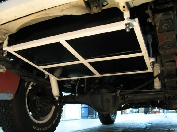

Well, it took way longer than expected, but this project is finally done. In the end I went with a custom tank where the spare tire used to be as the small stock tank I picked up didn't work very well. The fuel delivery system is now even simpler and no siphon effect needed.
http://dinoevo.de/2011/04/auxiliary-diesel-tank/

i am planning something very similar. however i learned when i was in Montana recently that a heated fuel pickup is necessary to allow travel almost anywhere any season. my intention is to use a heated fuel pickup in the rear aluminum tank, and that will be my main tank. but with heat, veggie oil will oxidize especially in contact with steel of the stock tank. so the idea is to not have the tanks connect or share fuel, but fill and pickup for each tank are separate. however that will require yet another filler drilled and mounted into the side of the vehicle!
maybe i missed it, but how are your veggie tanks vented?
tanks!

Sexy tank
Re: Additional tank - how?
Looks lovely white !
Too bad it's not a veggie conversion

Yeah no veggie for us. This is a Diesel only tank as it is way to complicated for our taste to do the WVO thing on a long road trip. I'm not sold on the idea to trust strangers with their filtering process. If this van would stay in Vancouver I would not hesitated to do the conversion though.
After Oil, I'm pretty sure AndrewH can make you this tank for a WVO setup as well. He also sells his own kits: http://www.delica.ca/forum/deli-wvo-kit ... -3214.html
There is one vent line going to the second filler. The vent line on the stock tank stays as it is.

well, i know a welder locally and we do some work trades.. plans would be nice. i got some for a tank not unlike andrews, but i thought i might combine those somehow with yoursfexlboi wrote:
