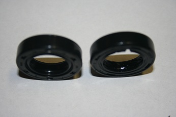

Cam Shaft <br />New style left old style right <br />35mm x 50mm x8mm<br />Part#S035050080T
Cam Shaft
35mm x 50mm x8mm
Part#S035050080T

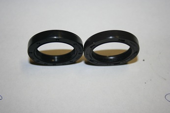

Upper Balancer Shaft<br />New style on left old style on right. <br />25mm x 35mm x 6mm <br />Part#S025035060T
25mm x 35mm x 6mm
Part#S025035060T

The differences are;
Different material,
Stronger metal retaining spring,
A third lip for oil retention,
Outer coating of seal case more pliable (aids in the seal staying in place)
Locally produced.
