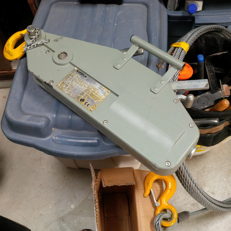

Tirfor's are a very handy tool. I bought one from Wesco Industries in Burnaby, BC (http://www.wescovan.com/ ). Image below. 4000lbs capacity, uses 11.5 mm wire. Also picked up a Campbell Chain, shackles, wire rope and straps. They have a lot of good stuff and prices are decent: http://www.wescovan.com/products.asp

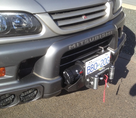

Re: Front winch mount options
Post by johnghaley »
This is the final product. I had the solenoids mounted behind the front body work so it would be out of sight and it won't interfere with the airflow through the radiator. I also have the winch operations switched in the cab too. I was after a clean look that didn't reduce the angle of approach.
John
stever1000
Posts: 258
Joined: Fri Apr 13, 2012 5:25 pm
Vehicle: 94 L400 SuperExceed
Post by stever1000 »
Wow that sure looks slick! Could you snap a picture of the mount to the frame too? What model of winch is that?
Awesome!
Post by macro »
Yeah, that looks really, really good. I would also love to see the mounting bracket. For ease of uploading, I find Photobucket the most straightforward for me.

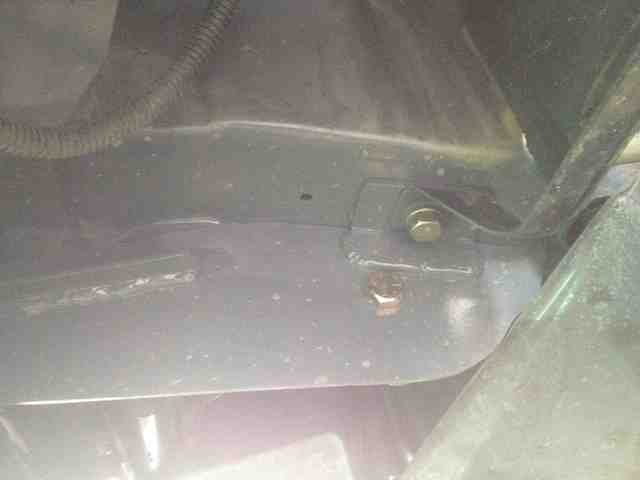

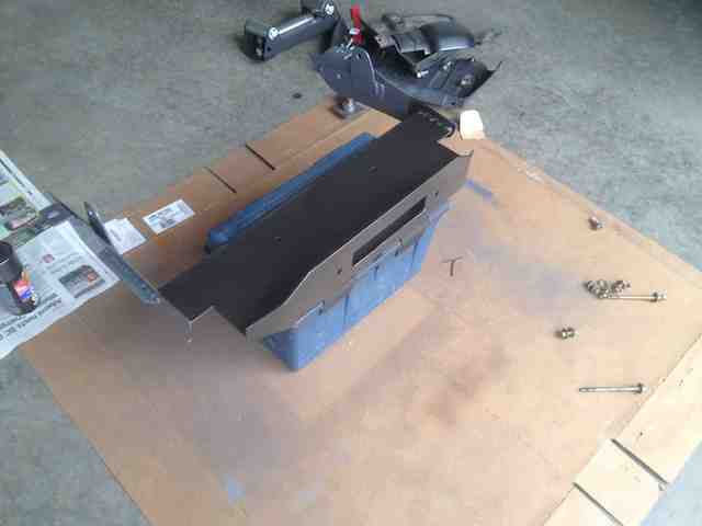

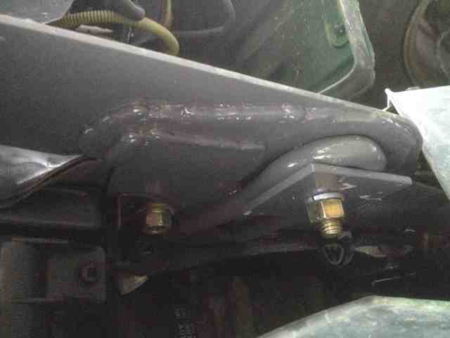

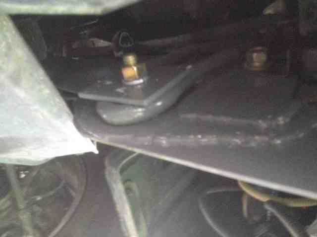

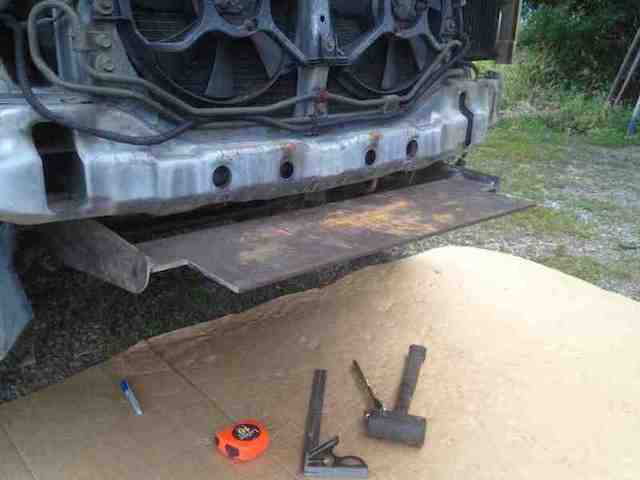

There are three points of attachment on each side. I used the bolt pattern from the steel tube bumper and I had a shims manufactured to fit inside the two tow loops. I hope this helps.
John H
I hope this will help
John H
