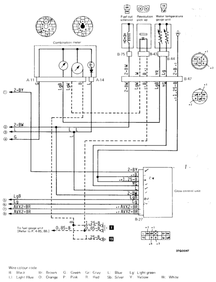

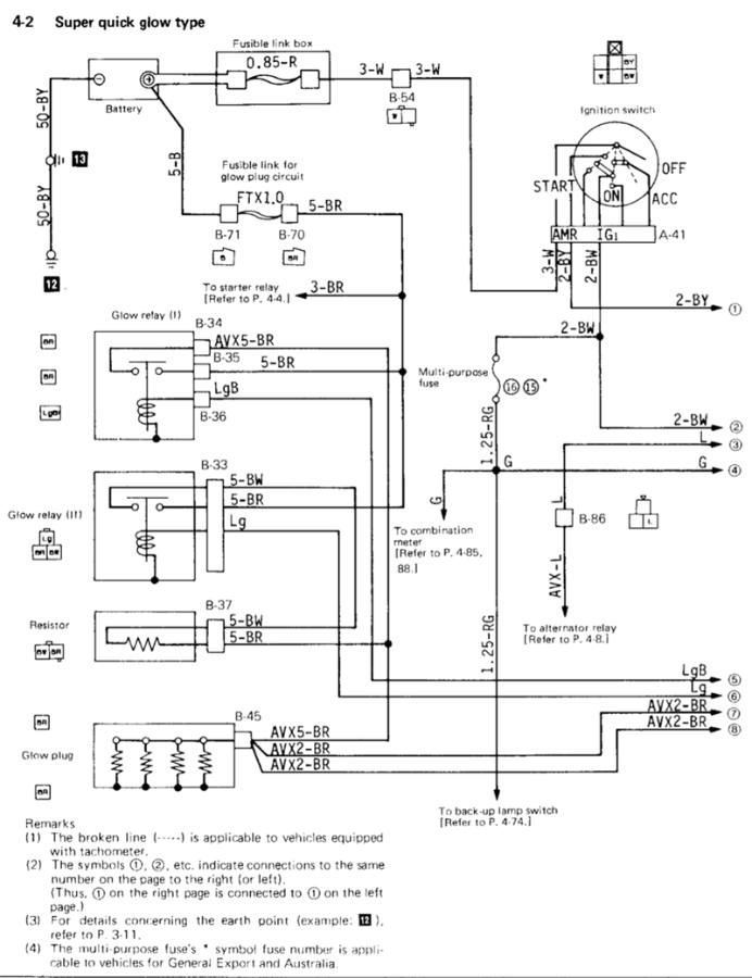

I'm interested in getting wiring diagrams for the glow/egr controller circuitry, or 'ECU' and perhaps moving to a manual GP system while I attempt to resolve my van's issues. In other configurations, I've retrofitted a momentary-on, two-position toggle switch as relay controllers. One position (up) for full glow. Down for after-glow. I'm guessing that the lower voltage plugs on the delica system mean there is no need to interupt the alternator to protect them from over-voltage when running, in which case manual after-glow is made more simple on the delica. If this were a true cold climate diesel the dropping resistor would be an intake heater!

weelsey wrote: I'm interested in getting wiring diagrams for the glow/egr controller circuitry, or 'ECU'
There's a full workshop manual in the Technical Reference Library: http://www.delica.ca/forum/viewtopic.php?f=17&t=17809 but the diagram you're after is this one:

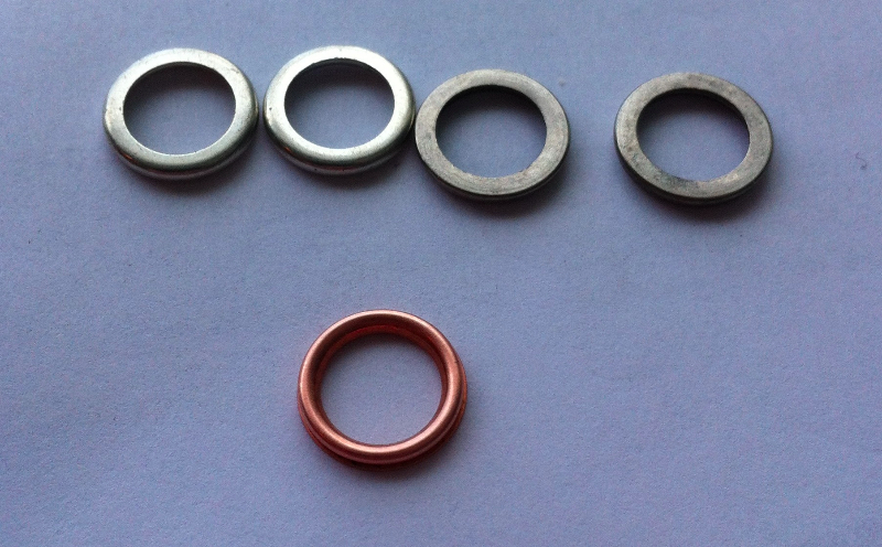

This is the heat shield from Mitsubishi (MD070718 copper) and perhaps suitable stand-ins from Toyota diesels that use the same nozzle type (PDN).
Dimensions are considerably the same (10.8mm O.D., 7.8mm I.D., 1.5mm un-crushed width). The obvious difference is the material (incidentally there are also two different pairs of toyota sheilds shown here - one stainless, the other apparently a more feromagnetic steel), but the less noticeable difference is that the edge of the curl is outward on the copper and inward on the others.
Any reason I should not go Toyota?
The toyota may use a injector protector cup in addition, but this would have no effect on the potential for carbon to accumulate in the recess of the shield.
Perhaps I'll be trying three different shields in my injector work and can report back on the results.

Are those washers going to crush without damaging the heads mating surfaces?

Good question, ChuckBlack. I was wondering myself what the difference was going to be in the compression characteristics of the different seals and if more torque would be required to sink them hard against the shoulder washers.
The injector bore, I would hope, is capable of handling the differences in the material strengths, so long as the travel of steel ones is sufficient. I cannot see any significant difference in the space that is allowed for compression in the steel units. The phots don't show the curl of the shield in order to gain sense of how they far they will crush. But the travel looks good. perhaps the seats will need to be especially clean in order to conform to the seat.
