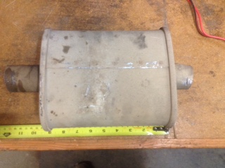

Well...a small muffler or resonator before the main one?? Here's a pic.
Anyway it is out of the way!

Phew. That's a resonator. Catalytic converters on diesel engines is a fairly recent thing- I was prepared to be amazed at Mitsubishi's advanced technology though!

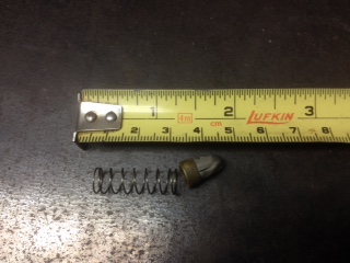

Hallelujah! Issues resolved! There was a hidden little screen in the fuel supply line right at the banjo fitting before the IP that was totally clogged. Such a simple thing and yet so hard to find! Truck is running better than ever, EGTs on the highway below 200C. Pretty relieved.
Here is the culprit. I'm thinking of putting it back in - it worked once and may need to stop some crap again. And now I know where it is.
