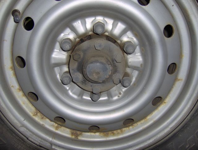

I have yet to hear any audible sound when shifting into and out of 4wd or locking and unlocking the hubs !
Every post i read has said you will hear a clunk click etc....etc... but on mine it is silent. I sure know it works though !!!
I had to take muy wife the womens hospital in vancouver on wed. during the storm. Trucks and cars were sliding backward downhill on 56th ave (route 10) and
it was stop and go on the hill. The delica acted as though it were on dry pavement. The tires never spun !! I drove to the right of all the slipping and sliding vehicle and went
right up the hill. Simply amazing !!! I love this van !! We would not have made it in most vehicles with just all-season tires.
cheers
The Mighty Boosh !!
Re: Adding weight to your Deli for the winter
fishslapper wrote:I have yet to hear any audible sound when shifting into and out of 4wd or locking and unlocking the hubs !
Do your hubs look like this?:
flange hubs.jpg (46.41 KiB) Viewed 7790 times
If so you have hubs that are permanently locked so no clunking will be heard! :-D :M
