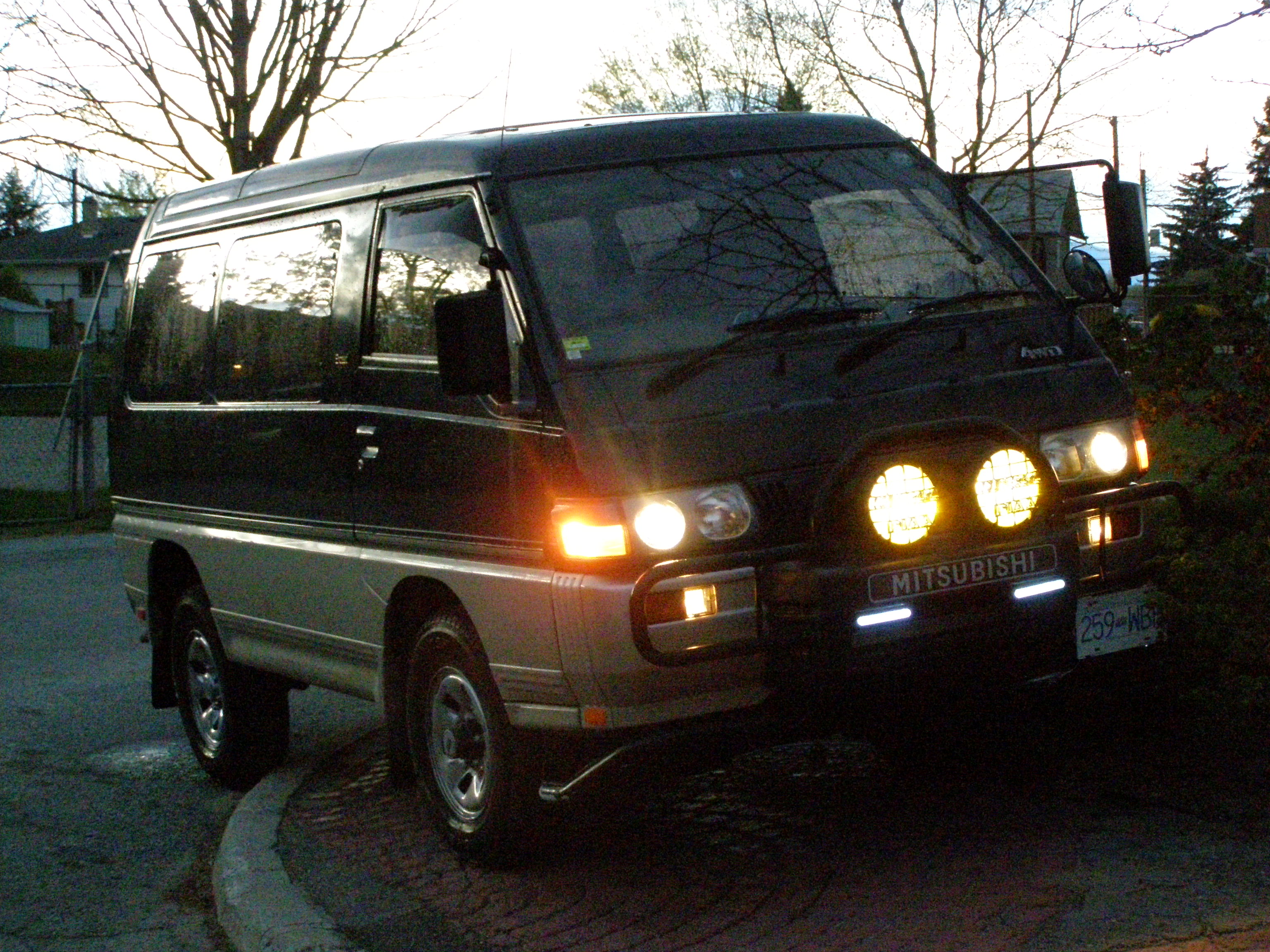

Mardy installed these on my ride about 5 months ago.I am totally happy with with them no problems at all.They look awsome at night..
- 142.JPG (1.29 MiB) Viewed 6164 times

Awesome looking led's. They'll be my first choice if I can't put an LED or small halogen bulb inside the headlights. Price is good!
Wouldn't it be better to have the LED's (DRL's ) off when the headlights were on? or was the pic just for display?
Do you have a watt, lumen or candelas rating for that light?

Hi there,Thanks for the compliment.
The LED'S are on all the time.
Mardy Should be able to tell you what the Light output rating.

Not only would it be better, the law requires it. I find the strip LEDs aren't bright enough to really attract attention. I'm hoping that in the next year or so higher power ones will become available. When that happens I'll replace my H3 lights with LEDs.thelazybrownfox wrote:Wouldn't it be better to have the LED's (DRL's ) off when the headlights were on?
