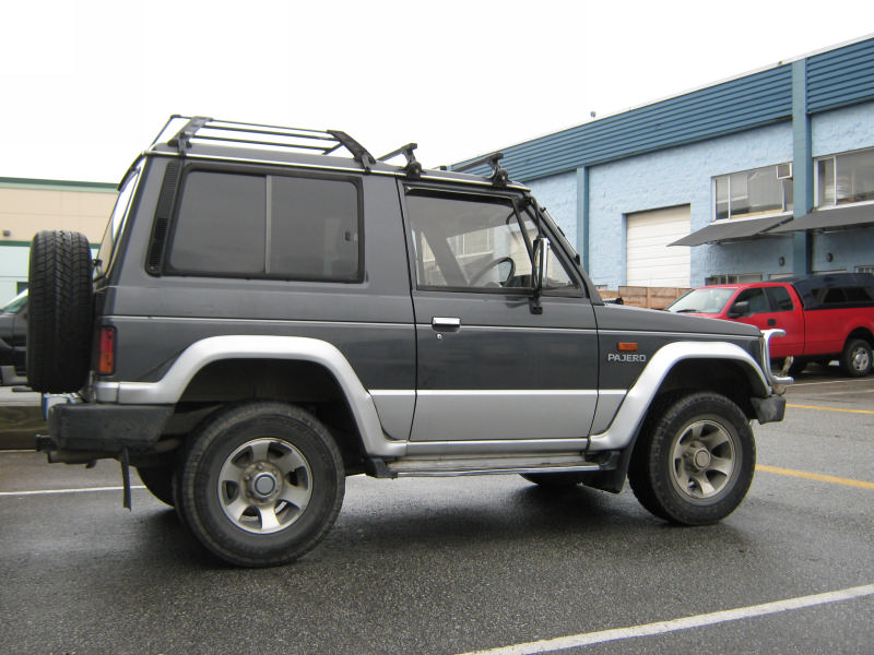

For pajero owners who have difficulty to source replacement coil springs,
we have heavy duty coil springs in stock for pajero LWB.
It is 1.2-1.3inch lifted up at rear when you install into your LWB pajero.
http://www.delica.ca/trader/index.php?p ... gs_for_LWB
Also here’s regular replacement coil spring for LWB pajero.
You can use these coil springs for your SWB pajero 2 inch lift up ( See attached pic ).
http://www.delica.ca/trader/index.php?p ... _Pajero_or
Thanks.
Steven
Thanks.
Steven
